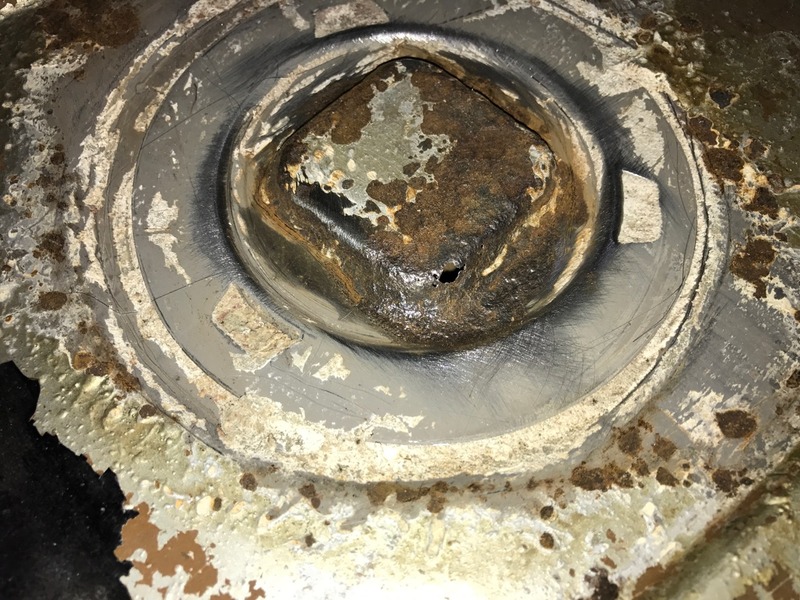

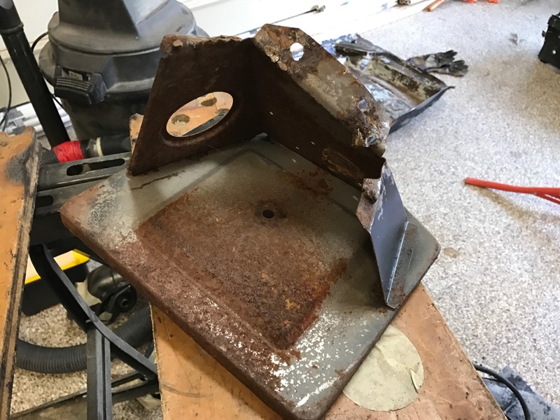

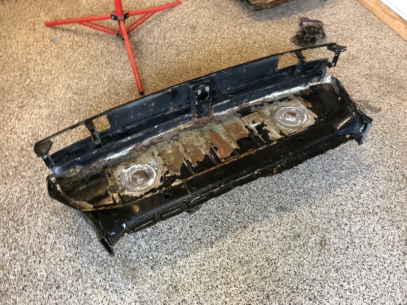

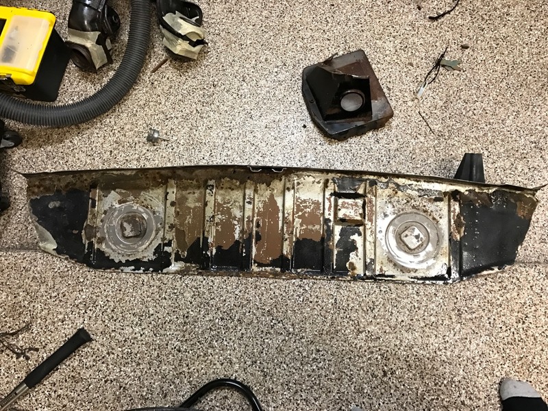

Spent a little time this weekend working on some of the repair panels I cut out of my '72 parts car.
I will use this section to replace the missing rear trunk floor on my car:
(IMG:http://www.914world.com/bbs2/uploads_offsite/i120.photobucket.com-19557-1479353645.1.jpg)
I trimmed it down to what I will need and cleaned up for a closer inspection:
(IMG:http://www.914world.com/bbs2/uploads_offsite/i120.photobucket.com-19557-1479353645.2.jpg)

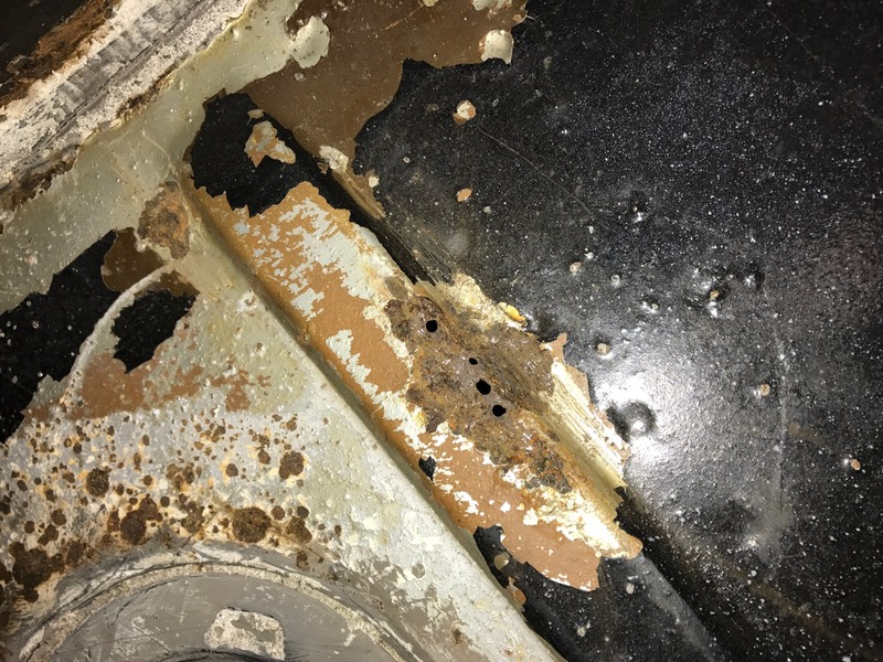

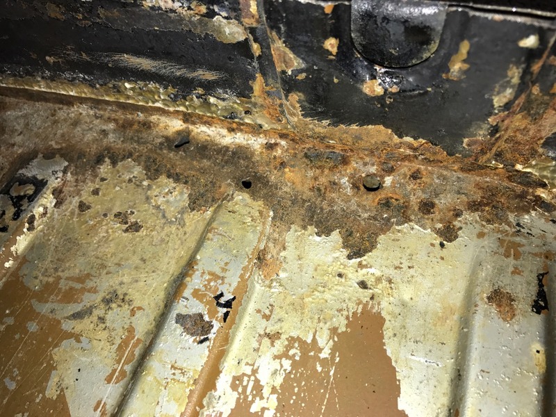

The typical rear edge where it meets the rear fascia is rusted pretty badly:
(IMG:http://www.914world.com/bbs2/uploads_offsite/i120.photobucket.com-19557-1479353645.3.jpg)

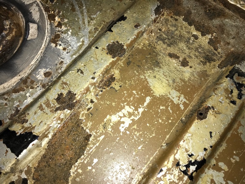

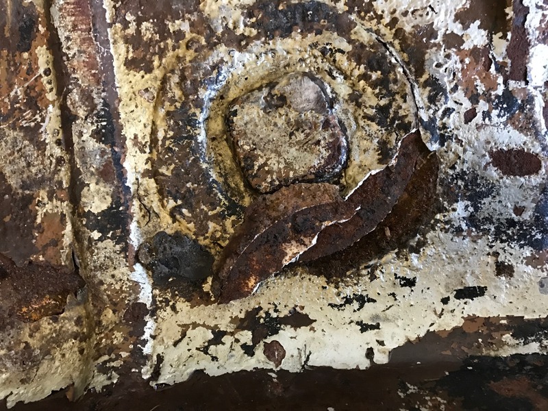

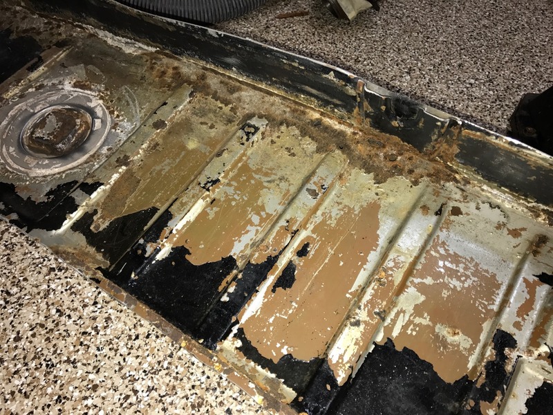

Closer inspection finds some holes:
(IMG:http://www.914world.com/bbs2/uploads_offsite/i120.photobucket.com-19557-1479353645.4.jpg)
(IMG:http://www.914world.com/bbs2/uploads_offsite/i120.photobucket.com-19557-1479353646.5.jpg)
(IMG:http://www.914world.com/bbs2/uploads_offsite/i120.photobucket.com-19557-1479353646.6.jpg)
(IMG:http://www.914world.com/bbs2/uploads_offsite/i120.photobucket.com-19557-1479353646.7.jpg)
I will be trying to fill some of these holes with a little help from a copper spoon. Hopefully I can salvage this piece because a new one from RD is $$$.
I'll also *try* to cut a patch panel out of this to repair where my car was chopped up for A/C. It definitely will need to be straightened and have a few crack seams welded up. It looks like the car was driven over a few too many things:

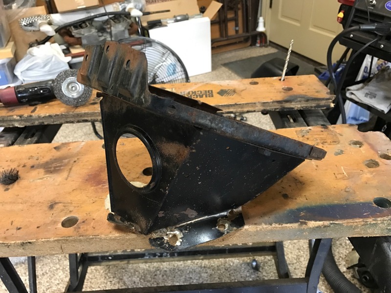

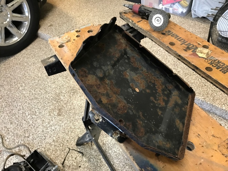

Lastly, I stole the battery box & tray out of the parts car. It's in mostly good shape save some surface rust and twisting I did getting it out. It will only need minor repairs:
(IMG:http://www.914world.com/bbs2/uploads_offsite/i120.photobucket.com-19557-1479353647.10.jpg)
(IMG:http://www.914world.com/bbs2/uploads_offsite/i120.photobucket.com-19557-1479353647.11.jpg)
(IMG:http://www.914world.com/bbs2/uploads_offsite/i120.photobucket.com-19557-1479353647.12.jpg)
That's it for now. Obviously these pieces will need more work in the future.
