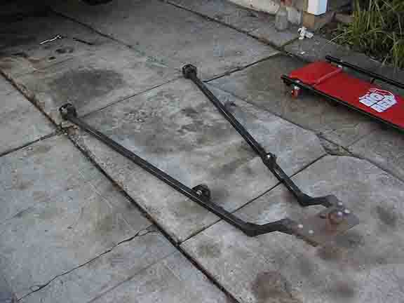

Lawrence took these pics at the MUSR. This would be a nice setup for my AX project. I would like to get a few more details on how / where the hitch was mounted. I assume the plug for the trailer lights just comes out of the trunk? (IMG:style_emoticons/default/confused24.gif)

trailer sub-frame

AndrewBlyholder   I trailered my tools and race tires to PCA and SCC...   Oct 19 2004, 02:27 PM
AndrewBlyholder   trailer sub-frame   Oct 19 2004, 02:28 PM
AndrewBlyholder   sub-frame bolted to car   Oct 19 2004, 02:29 PM
AndrewBlyholder   attachment to engine bar with hitch pin as shear p...   Oct 19 2004, 02:31 PM
itsa914   Hey, now were talking :clap:   Oct 19 2004, 02:31 PM
AndrewBlyholder   mounting at tranny   Oct 19 2004, 02:35 PM
AndrewBlyholder   riser section - tubes are 1"x1". Dont' rememb...   Oct 19 2004, 02:38 PM
