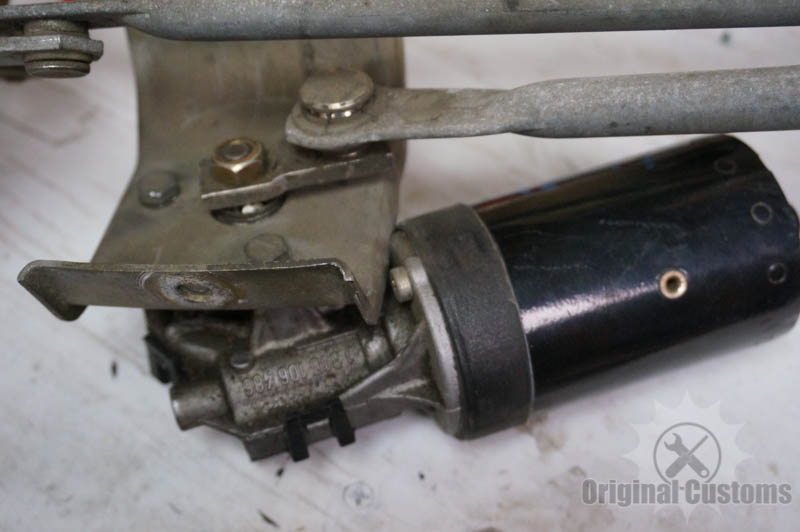

Just bought a wiper motor off a 2003 Boxster to see how interchangeable they are with ours. Modern speed wipers is on my list of things to make the 914 wife-worthy.
Pictures and thoughts once the part arrives later this week.

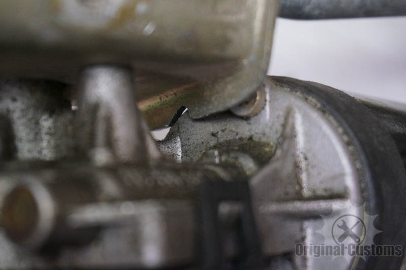

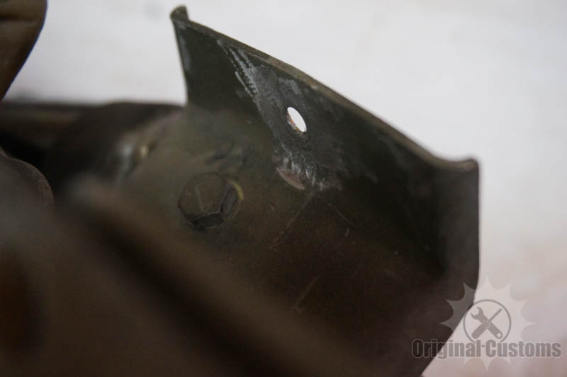

Well, 3.5 years after mocking this up, I actually did the install. My original assessment was right on. I notched the mount just slightly to make clearance for the motor body and removed the rubber mounting nut. I'll weld a new nut on the other side (that'll make it even harder to install). Now everything bolts up fine and the motor moves the assembly, just like it should.
I'm gonna go install it in a car now and see how it looks in real operation.

McMark   Differences: - The wiper linkage arm on the Bo...   Jul 22 2012, 10:42 AM
smj   - The bolts and drive shaft on the 914 motor are ...   Jul 22 2012, 04:13 PM
McMark   Here's a couple shots with the cover off. I n...   Jul 22 2012, 11:10 AM
kg6dxn   Great photos! I can really see all the dirt an...   Jul 22 2012, 11:38 AM
McMark   Stock 914 wiper motor looks exactly the same on th...   Jul 22 2012, 01:30 PM
9146986   If you can do the motor swap, and figure out how t...   Jul 22 2012, 01:52 PM

McMark   Well, that was an easy install. No surprises at a...   Nov 28 2016, 01:22 PM
