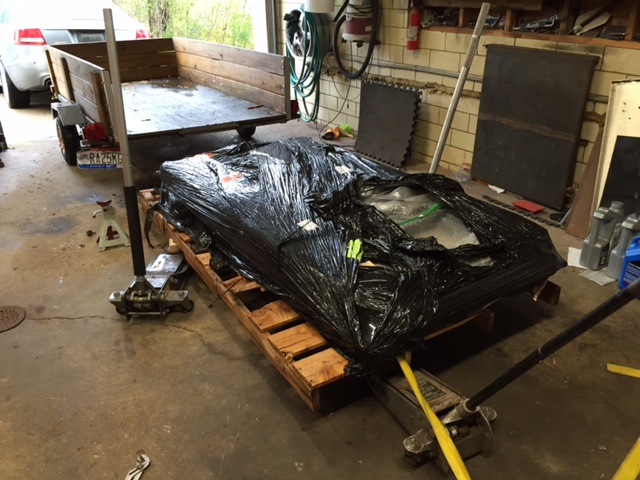

I got my TD6MR lift from Greg Smith Equip. last week and had it delivered to work. Thanks again “porsche913b” for getting us the $50 discount.

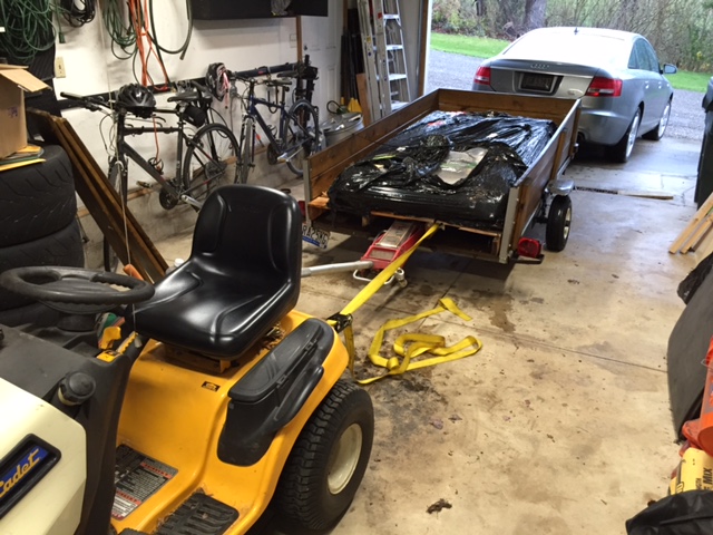

I used the forklift to load it into my trailer and backed it into the garage. I used my tractor to pull it out of the trailer enough to get three jacks under the skid and lower it to the floor.

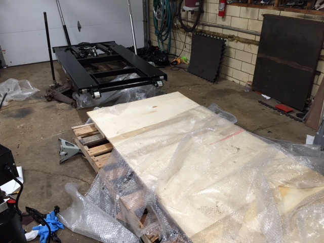

I then used a steel bar to slide it slightly off the skid and then used the jacks to lift it off of the skid.

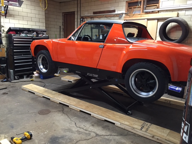

I built the ramps using one sheet of plywood and two layers of 2x4’s and they are a total of 14’ long. I started with just one layer of 2x4’s but it was just a little too low since my car is lower than shock. At some point I would like to sink it into the garage floor but this will work for now.
As everyone has said previously I really wish I had bought this a long time ago since it works fantastic for my 914.
