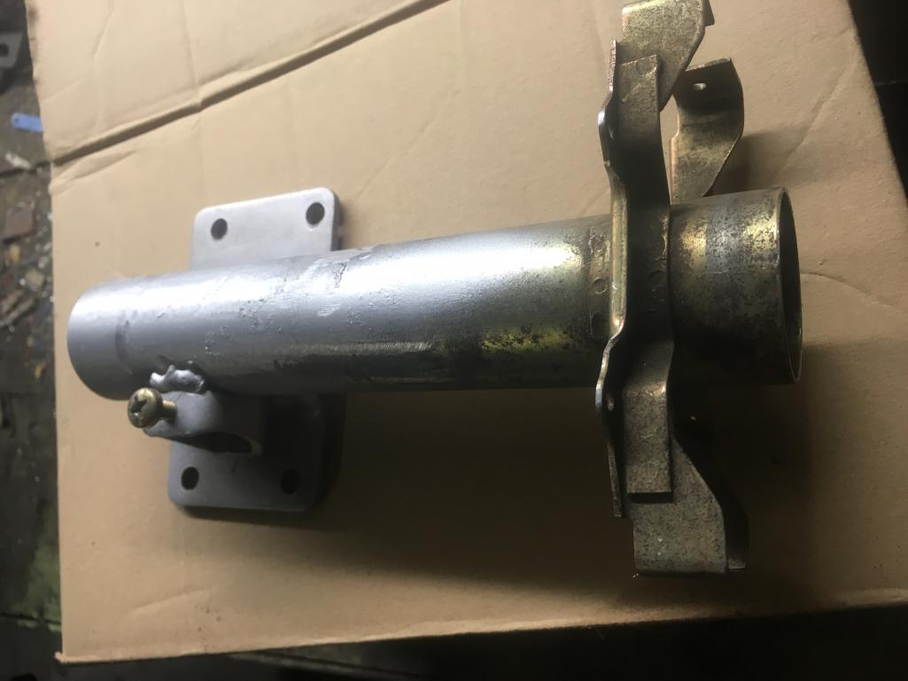

Nutter965   Side tracked again .... 6 style steering column fa...   Nov 28 2016, 04:02 PM
