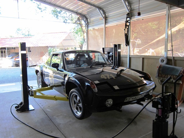

consider this alternative - MaxJax - a lot less install work and lifts 48" - easy R&R 914 engine-trans - mine was $1900 delivered
- and - it unbolts & gets out the the way when you want the space for other things - no forklifts required
you can come look at mine & try it at zip 95635 (40 miles away from Justin)
