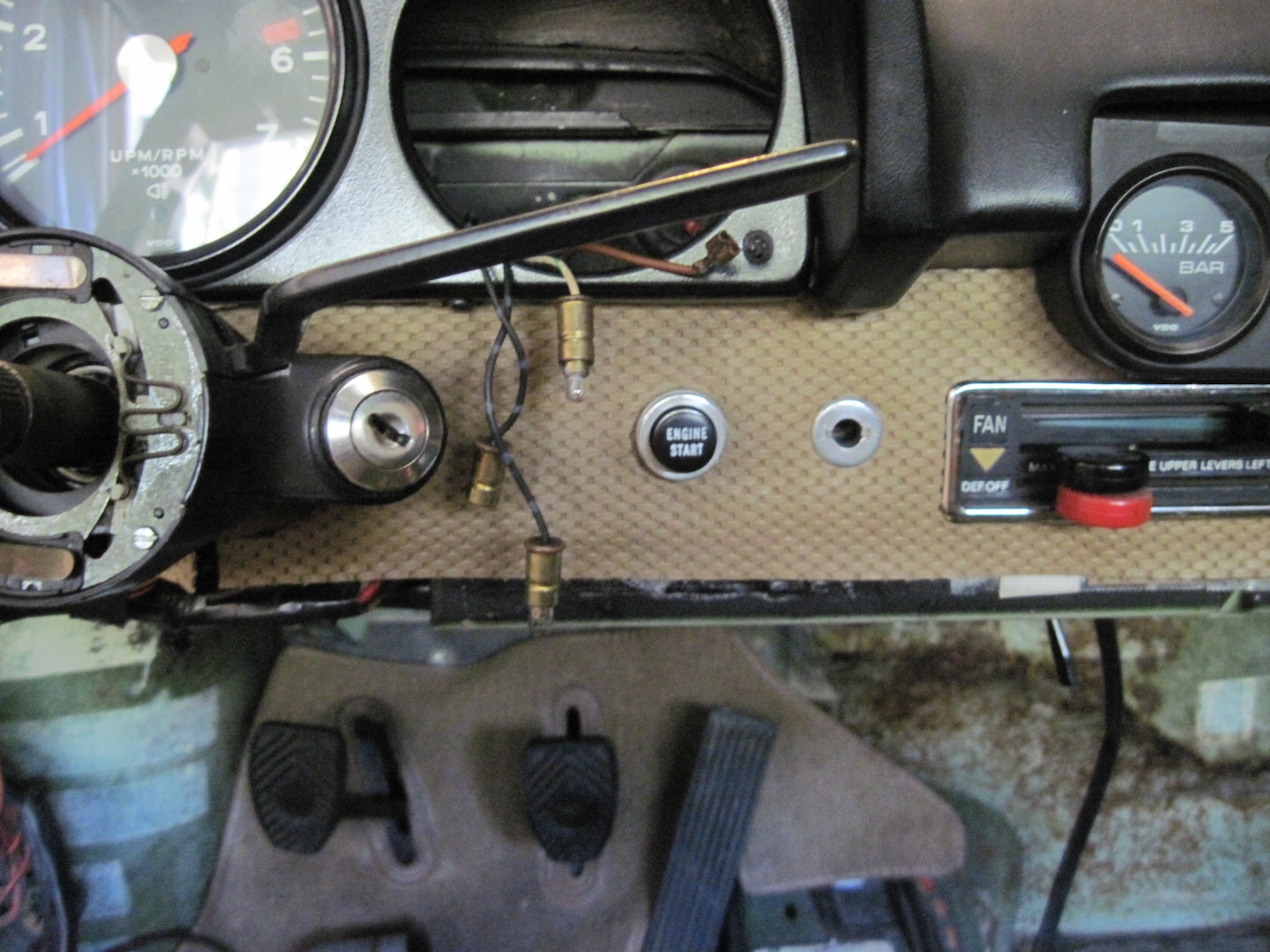

That's how I set this one up (aftermarket ignition switch was "iffy" in the start position):
Waytek "engine start" pushbutton installed in the cigar lighter hole; no new holes or cuts or anything. "Switched +" from fuse box to push-button (hot when ignition switch is "on"), then larger yellow wire direct from pushbutton to a Ford relay on the starter.
Font/type on the switch matches pretty well too . . . (IMG:style_emoticons/default/smile.gif)
Hope this helps.
