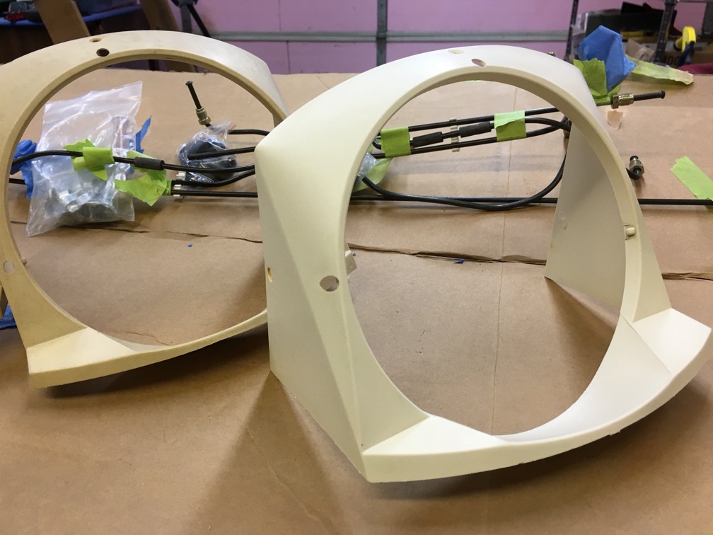

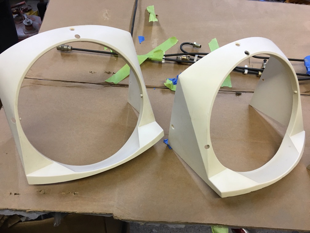

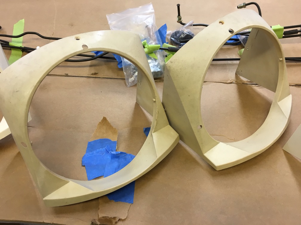

Started with 3 unpainted very good condition surrounds.
10% bleach, 24 hours.
Untouched set
Untouched & bleached.
Untouched & bleached,& bleached and 600 scotch bright pad, and light polish.
Bleached, 600, polished.
