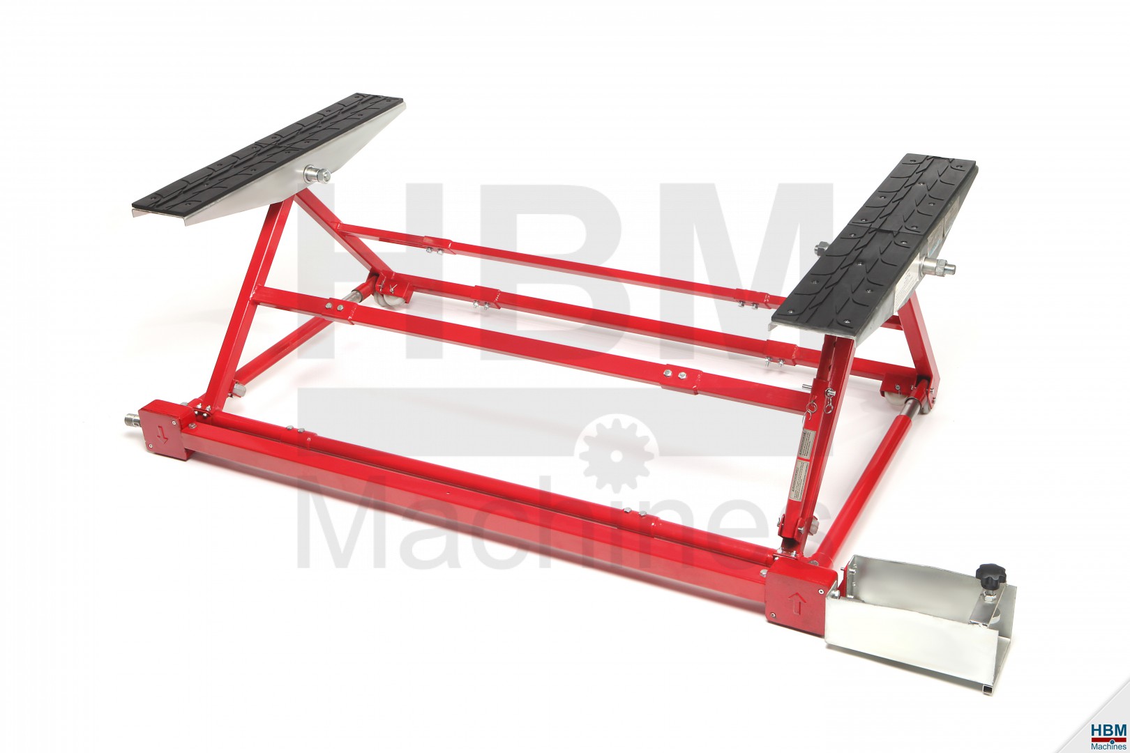

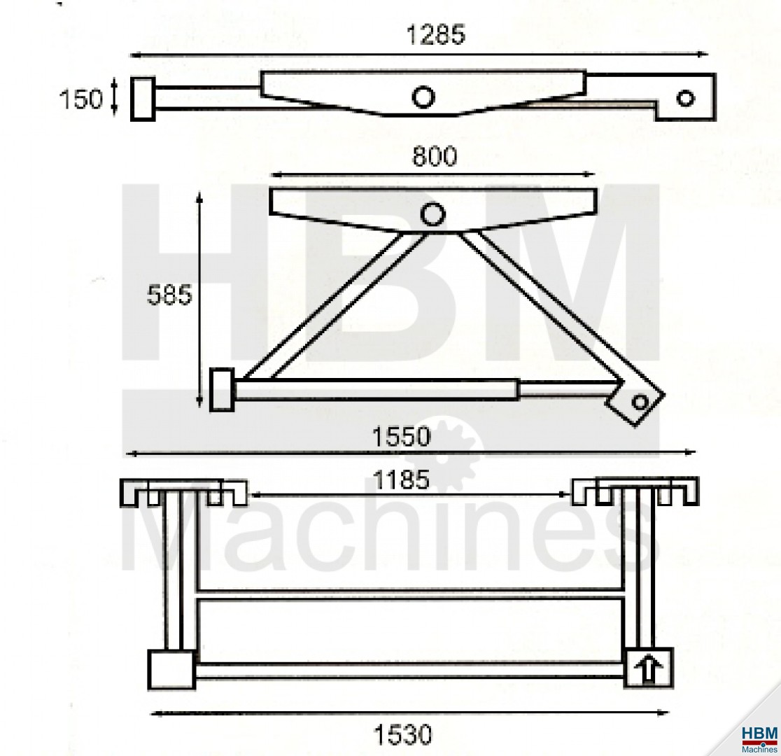

Interesting post, since I was looking to find info on a tilting lift and wanted to find out if they are suitable for 914's. The ones shown are a bit similair to what I was looking at, but slightly different.
Can we use a small Tilting lift on our 914's ? Or will 914's not like the place on the car they are lifted with this ? Right now I use the donuts to jack up the car, but this would help me a lot if this was possible.
It is a lift like this:
it is really low when 'at rest' and does not take up a lot of space (measurements are in mm, millimeters)
a similair thing in action (nice relaxing music in the background)
https://youtu.be/vQT1-EibbbE
I understand there are better alternatives than this, just wanted to hear if this was usable or not because of the way it lifts the car.
Thanks for your advice or opinion.
