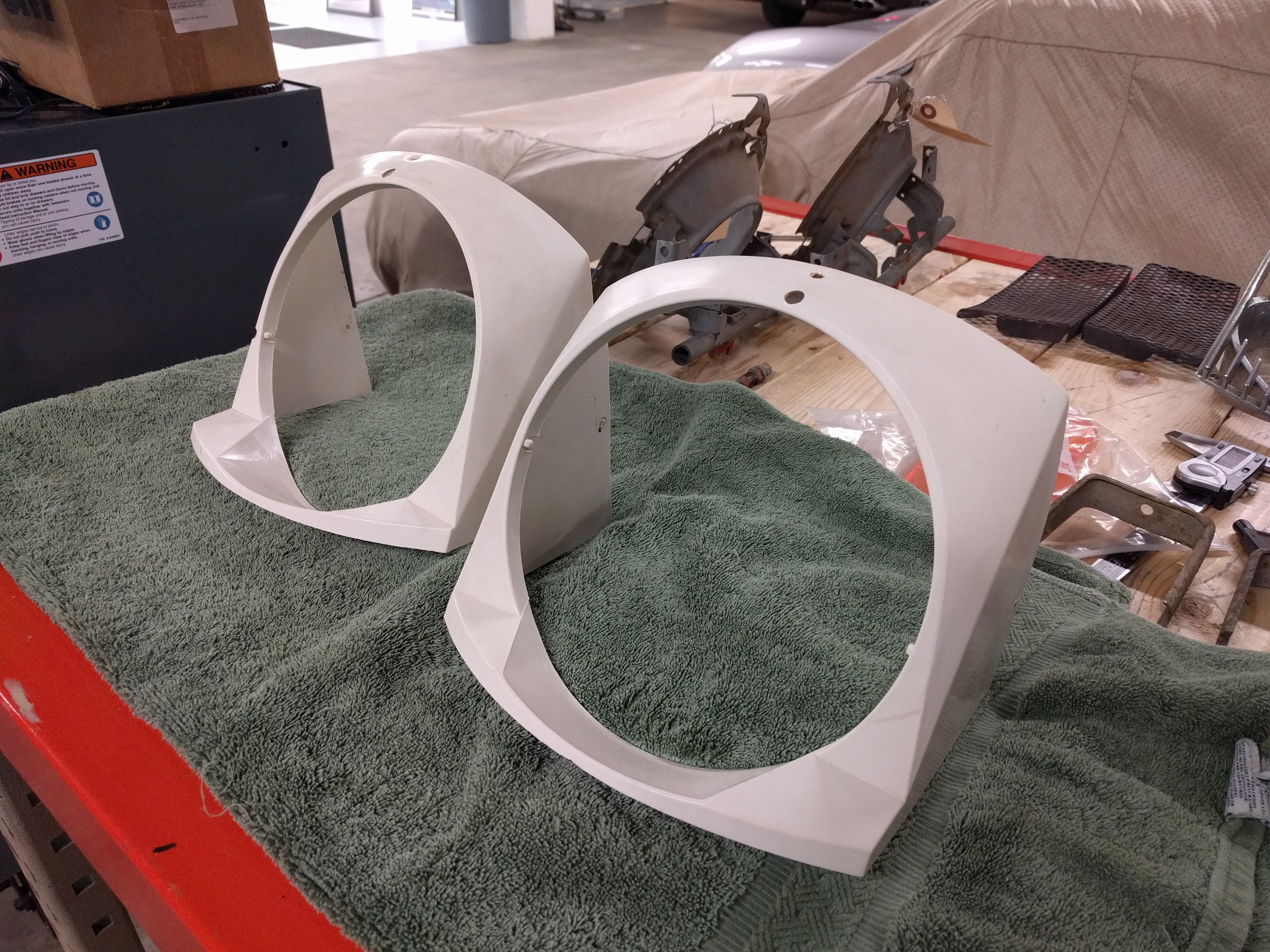

Here is after 24 hours of the 10% bleach recipe.
I am pretty happy how they came out as is. I will try some polish too - maybe the Meguiars plastic polish.
