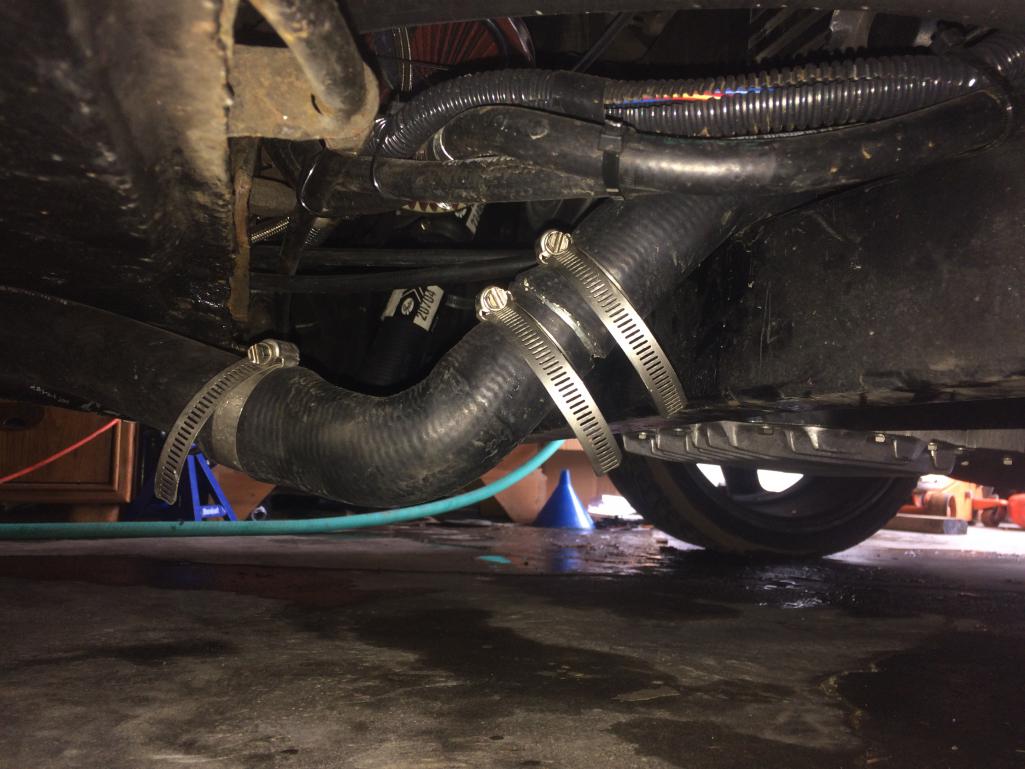

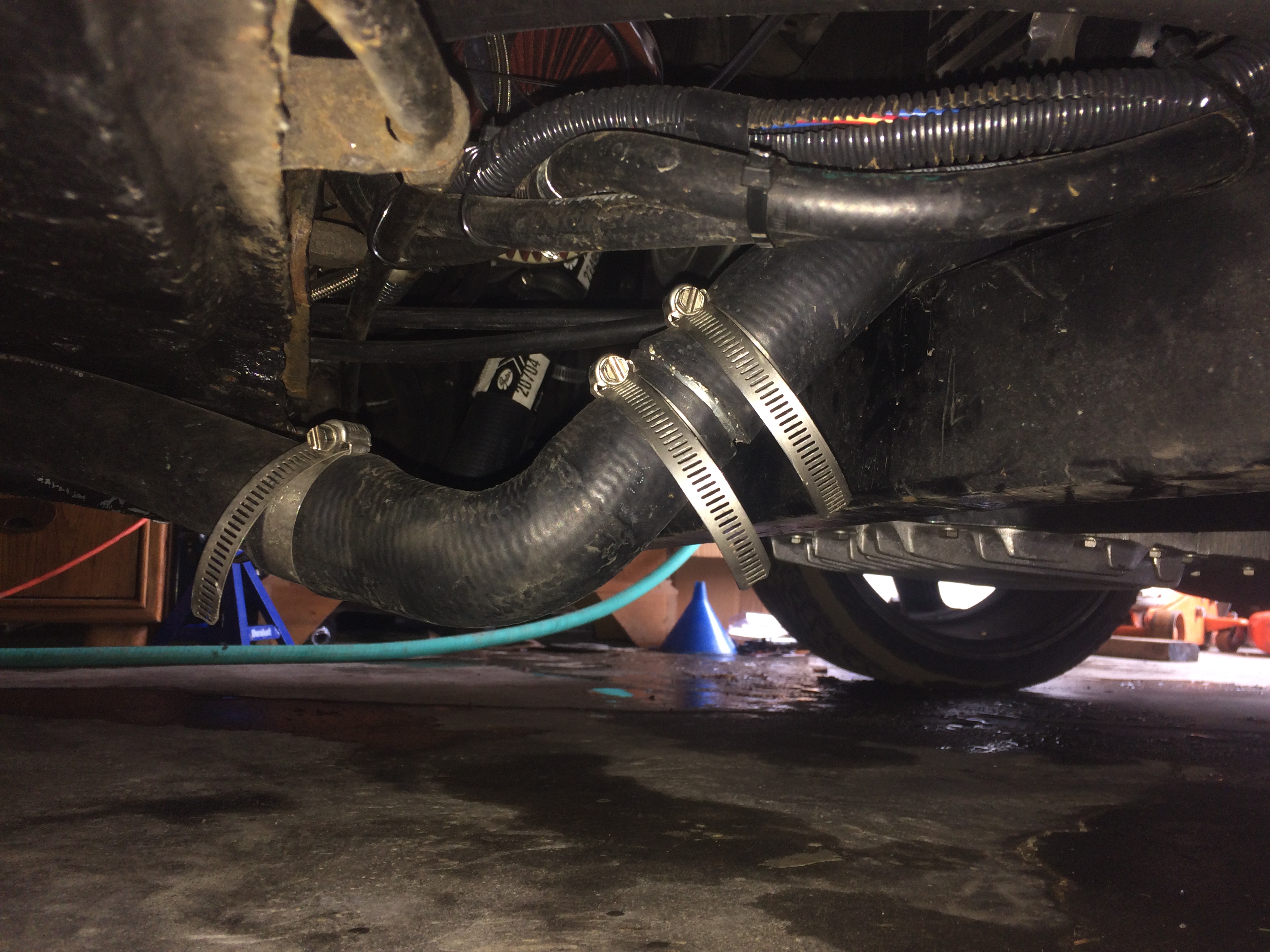

Ok so the hoses r nothing special the go from the engine like any subaru, both go down and run on a line under the car then go straight to the radiator no. leeds except the radiator cap and the overflow tank. my bleed in the back however is the turbo reservoir which has a line going from the block to it, then from it it goes to the turbo and back to the block as simple as can be. the heater pipes on the block have a pipe going from one end to the other no core nothing just 2' of hose. Attached Image now whats interesting and exactly what i thought would happen, i pulled the lower radiator hose off while running (dangerous i know) but the fluid in the hose remained stationary instead of being sucked up. meaning the thermostat isn't operating.

tazz9924   Ok so the hoses r nothing special the go from the ...   Dec 3 2016, 03:28 PM
