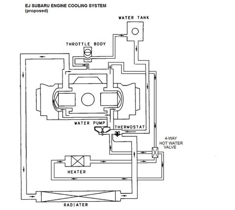

Click to view attachmentwhat is the 4 way hot wayer valve? also my air bleed is right next to the heater core

Yep....if there is no bypass ,then you have added a lot of restriction until it gets to the radiator.
A crude sketch would help. Normally the bypass is taken by the stat and not inline with the main cooling hose as the schematic shows.

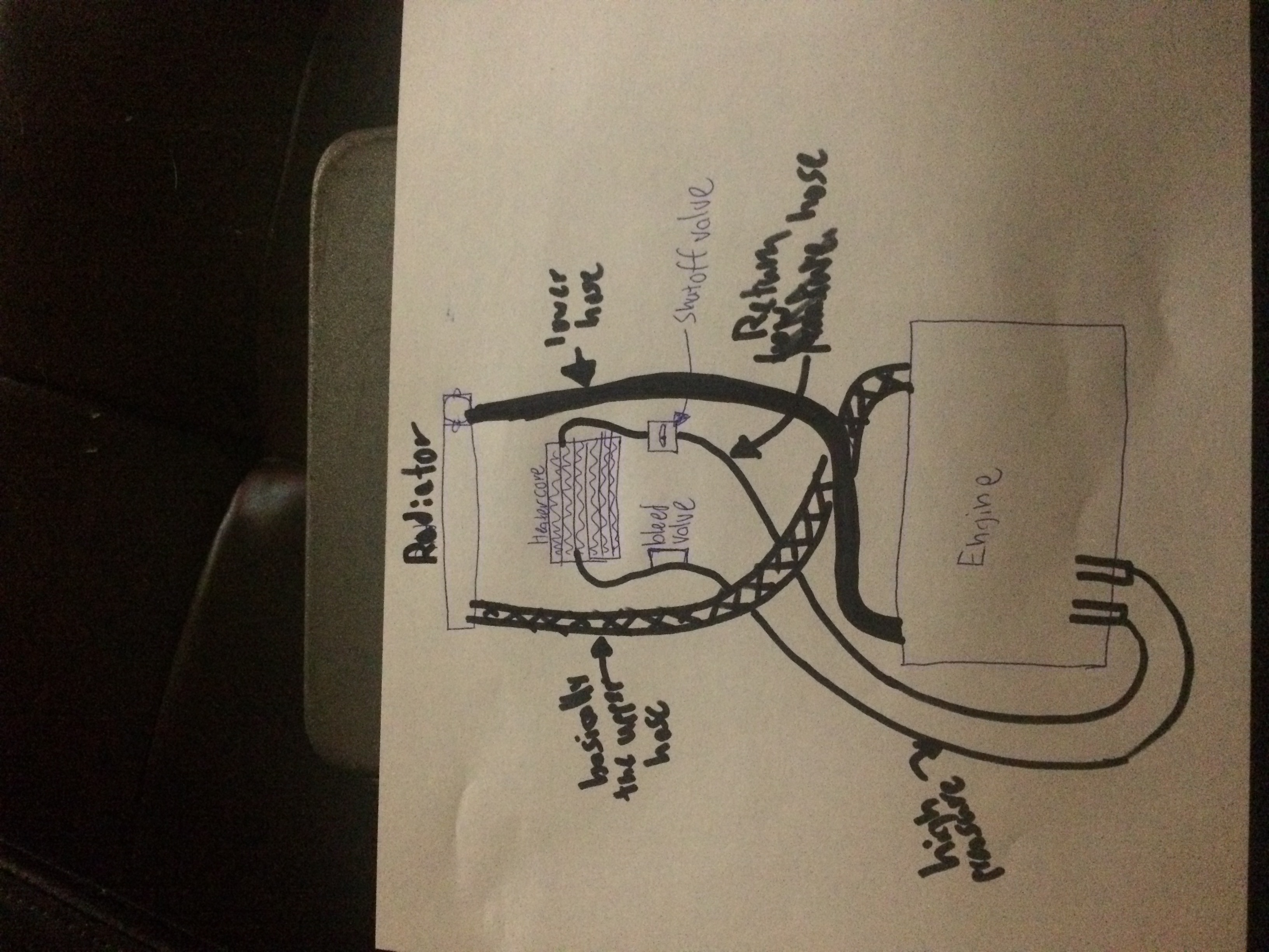

tazz9924

What ports are you pulling hot water off the engine at?

That looks like the same way I ran my heater.
If you close that shutoff valve it will cause the car to over heat.
On a Subaru the collant has to keep flowing in the heater curicut. I read that some where online and I know my car will run hot if I shut the water off to the heater core. Something about the thermostat not working right if that flow is shut off. Apparently we need to use a 4 way heater valve. It will shut off all collant to the heater core yet still keep the coolant flowing on the engine side.
My enginge is a ej22 and I'm not sure if thay are all the same in this regard.
To help get rid of any air in the sytem I am able to fill the system through the "bleeder" near the heater core. I used one of those coolant flush tees with a removable cap and fabricated a funnel to screw on to it.

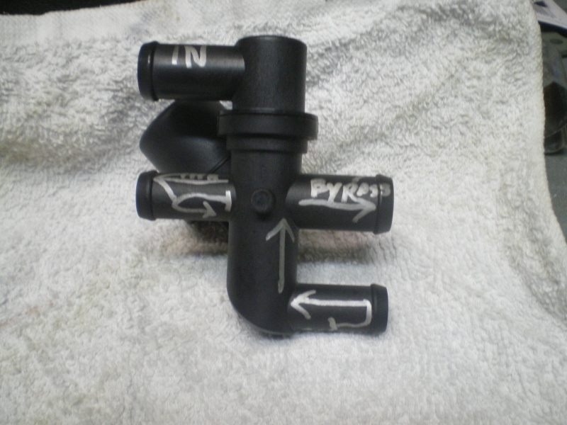

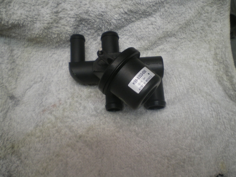

You need one of these:

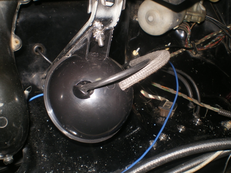

Click to view attachmentthe other side:
Click to view attachmentand you should use on of these vacuum reservoirs also:

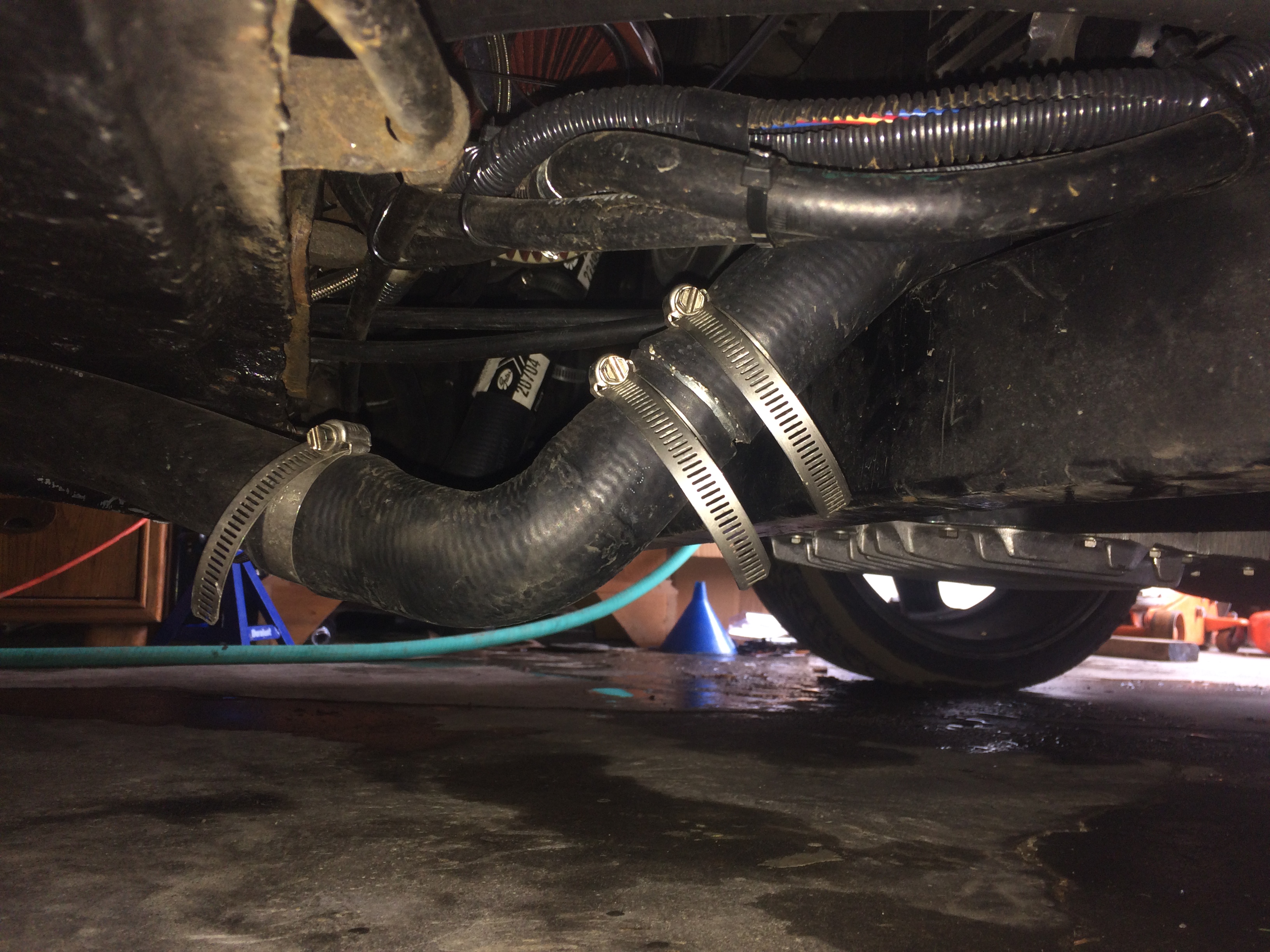

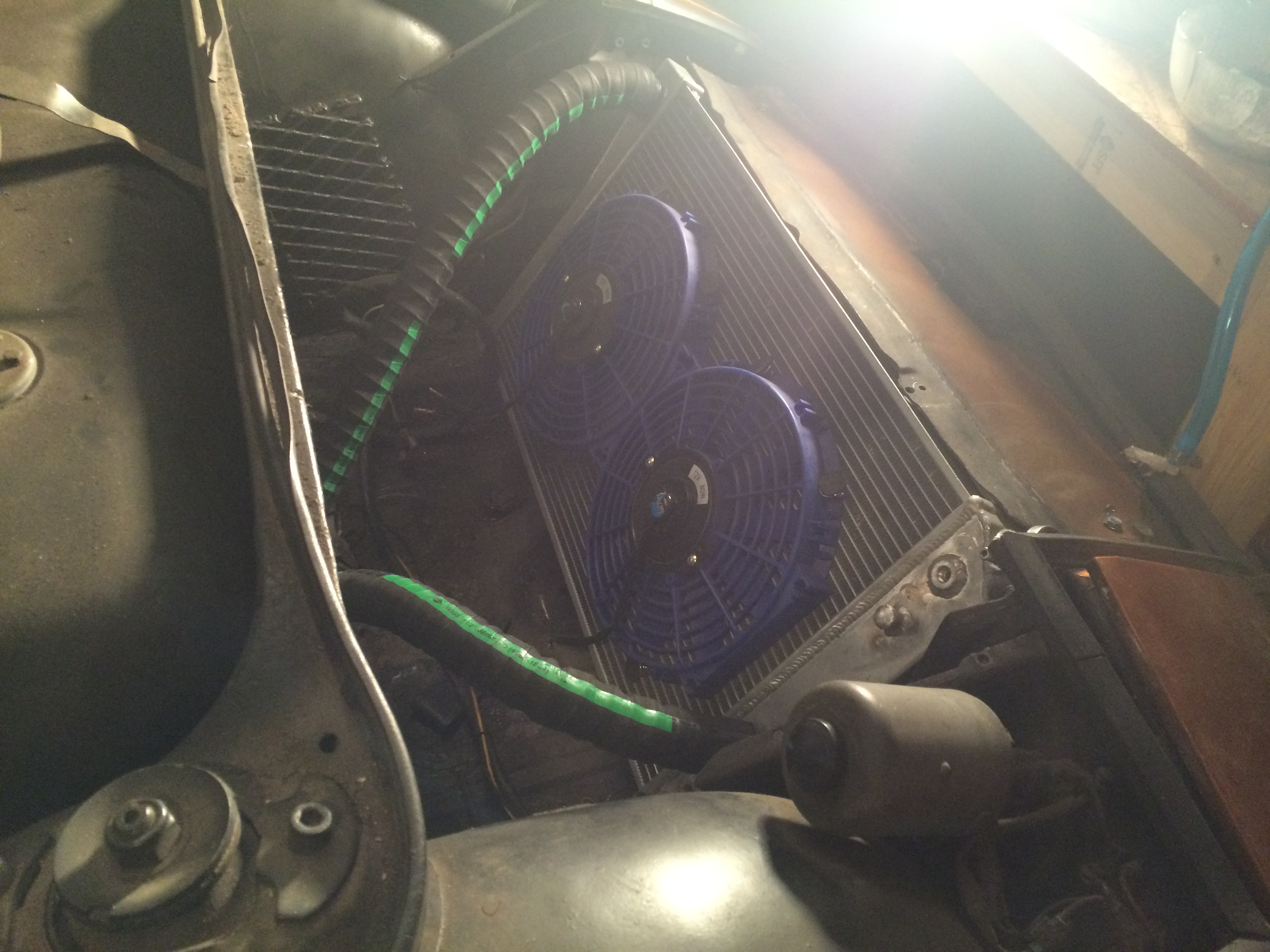

tazz9924
Dec 3 2016, 03:28 PM

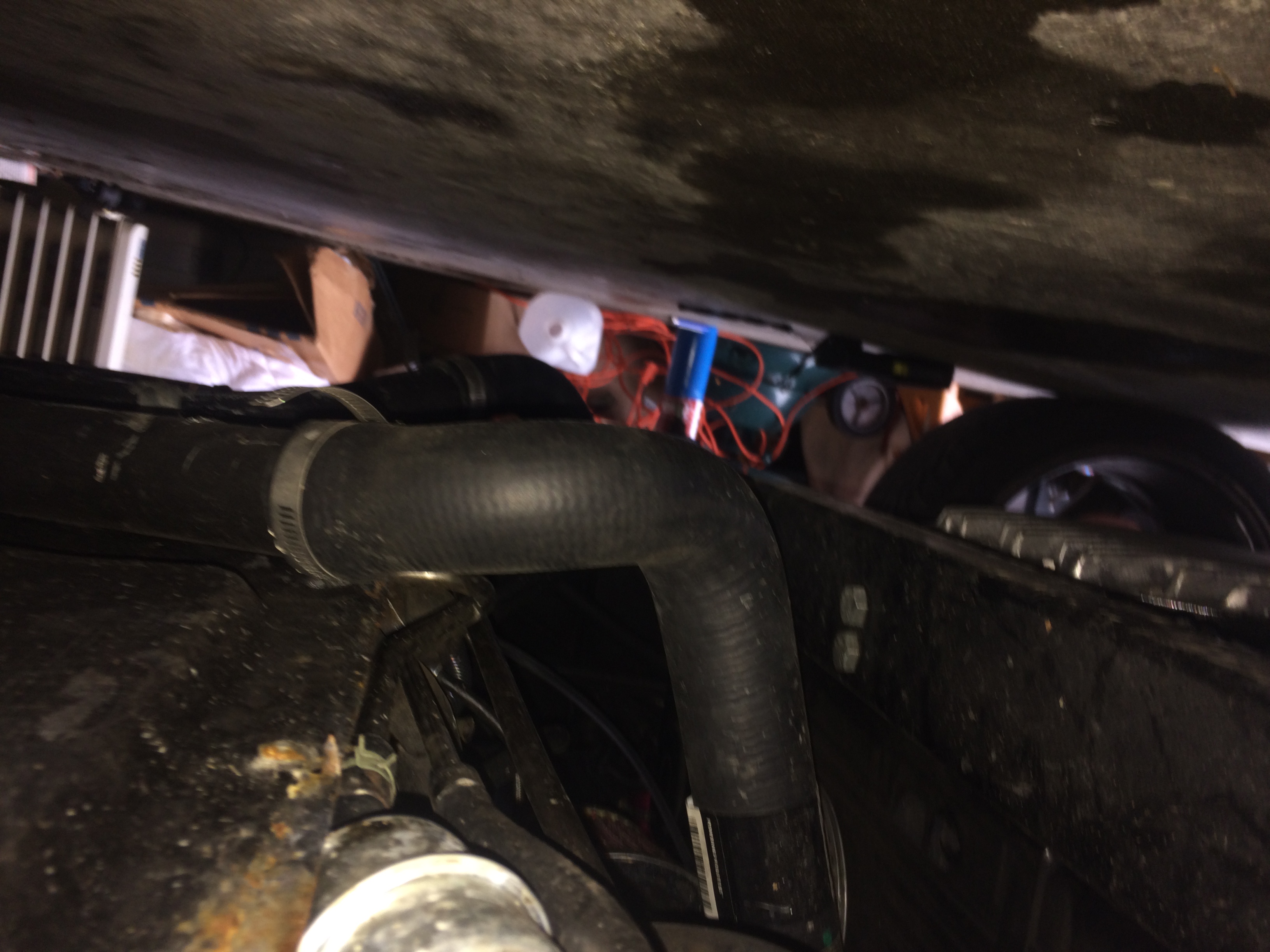

Ok so the hoses r nothing special the go from the engine like any subaru, both go down and run on a line under the car then go straight to the radiator no. leeds except the radiator cap and the overflow tank. my bleed in the back however is the turbo reservoir which has a line going from the block to it, then from it it goes to the turbo and back to the block as simple as can be. the heater pipes on the block have a pipe going from one end to the other no core nothing just 2' of hose.
Click to view attachment now whats interesting and exactly what i thought would happen, i pulled the lower radiator hose off while running (dangerous i know) but the fluid in the hose remained stationary instead of being sucked up. meaning the thermostat isn't operating.

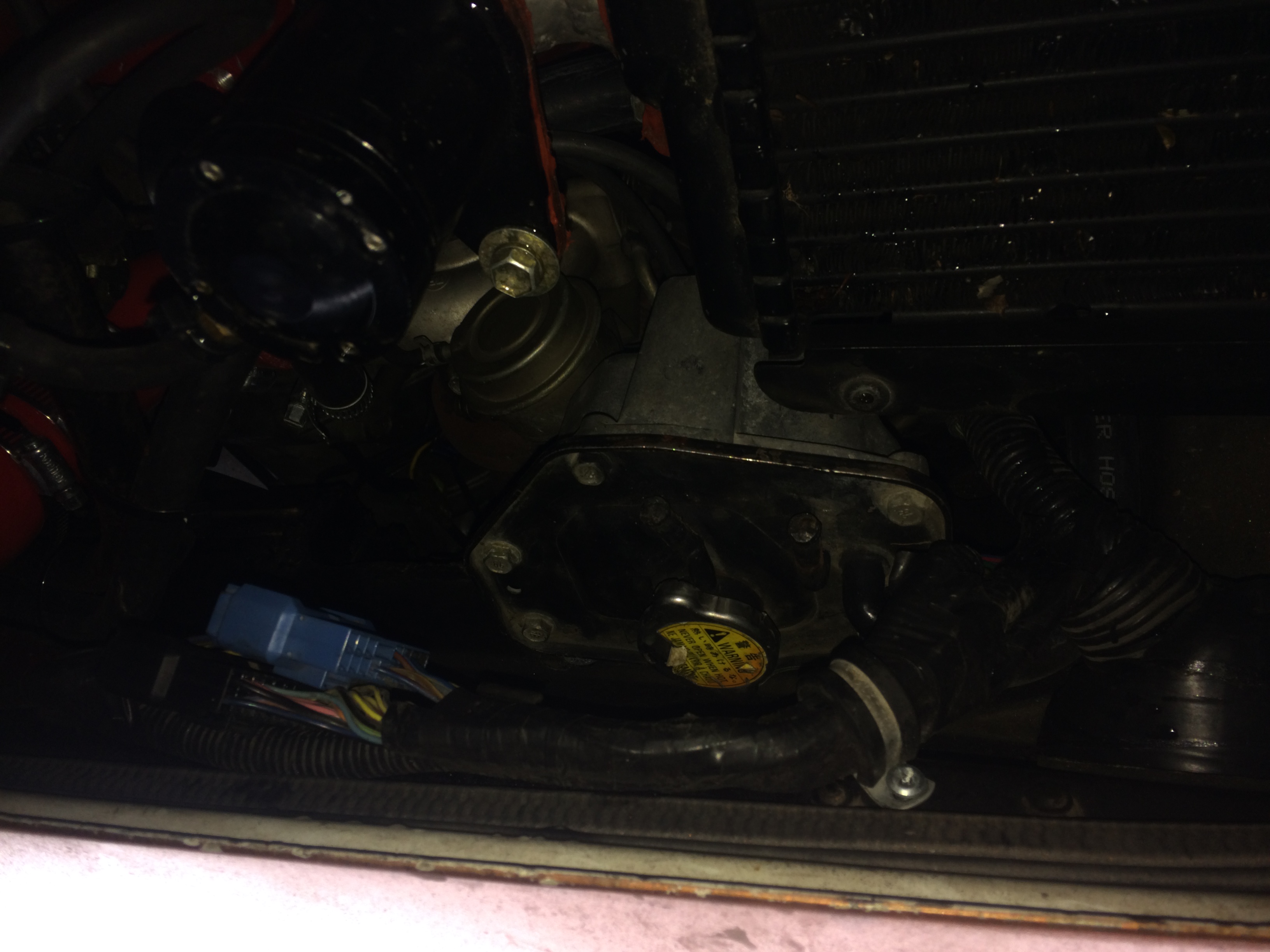

As 904svo said, there is no water on the engine side of the thermostat. Did you use a U bend hose to tie the two 15mm nipples that come off the back of the engine for the heater circuit? I don't know about the Bosch pump though. Maybe it's req'd on the 4cyl?? I'm running a six with the 4way by-pass valve I posted and it works like a charm. Those pics aren't very helpful. Take some like you look into the engine bay from both sides of the car. Use some light this time. That 2nd pic looked like a black cat in a coal mine eating licorice.
EDIT: Weird, I click on your pics and they flip over in the correct orientation. Wonder what causes that? Now I can see the coolers vent. It was on it's side before. If your thermostat plate has the 1/8' hole in it you can probably fill that soda jug gizmo up again and remove the cap off the cooler over nite. If you have those 2 heater nipples looped together at the block.
