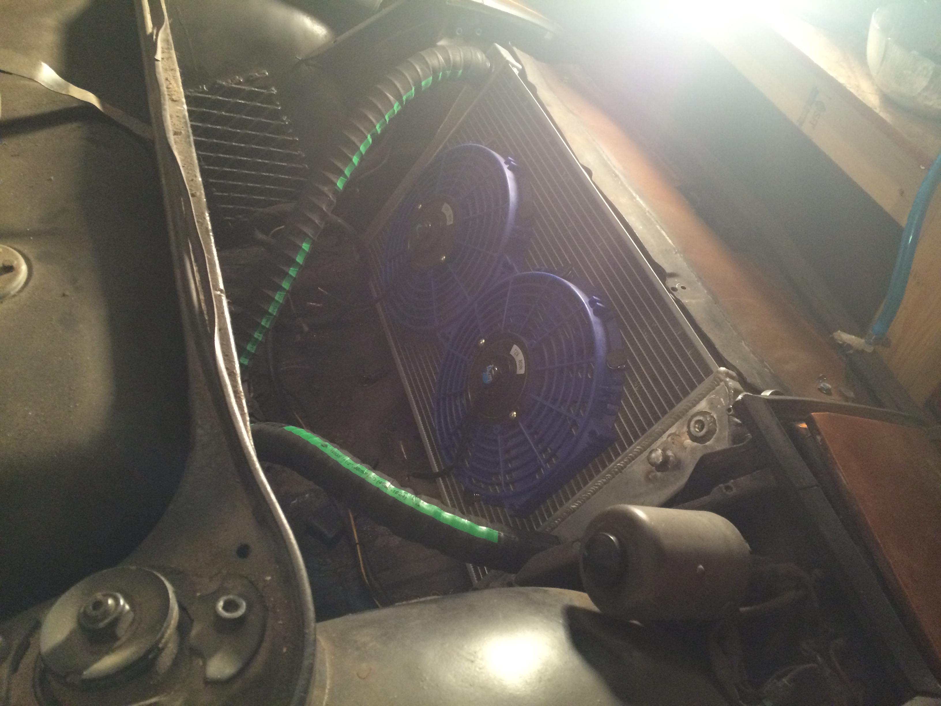

sorry for the crappy photo. then the heater core is in the fresh airbox with lines going through the old heater ducts.Attached Image

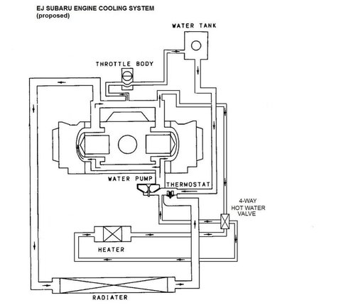

what is the 4 way hot wayer valve? also my air bleed is right next to the heater core

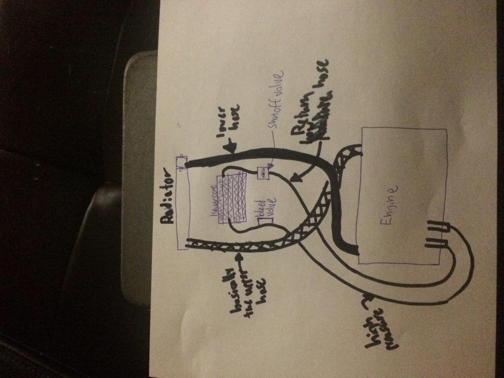

Yep....if there is no bypass ,then you have added a lot of restriction until it gets to the radiator.
A crude sketch would help. Normally the bypass is taken by the stat and not inline with the main cooling hose as the schematic shows.

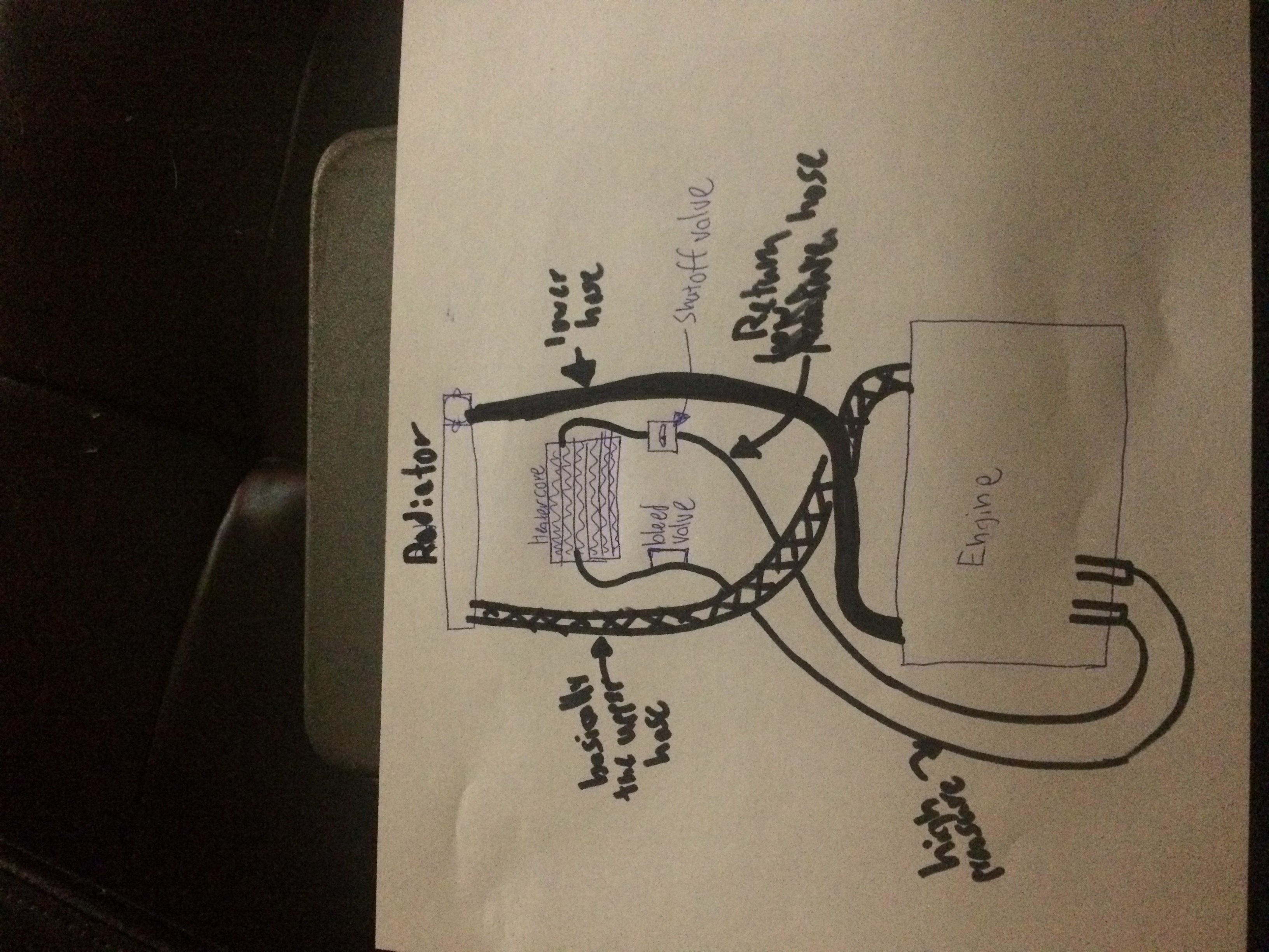

so its basically this

What ports are you pulling hot water off the engine at?

That looks like the same way I ran my heater.
If you close that shutoff valve it will cause the car to over heat.
On a Subaru the collant has to keep flowing in the heater curicut. I read that some where online and I know my car will run hot if I shut the water off to the heater core. Something about the thermostat not working right if that flow is shut off. Apparently we need to use a 4 way heater valve. It will shut off all collant to the heater core yet still keep the coolant flowing on the engine side.
My enginge is a ej22 and I'm not sure if thay are all the same in this regard.

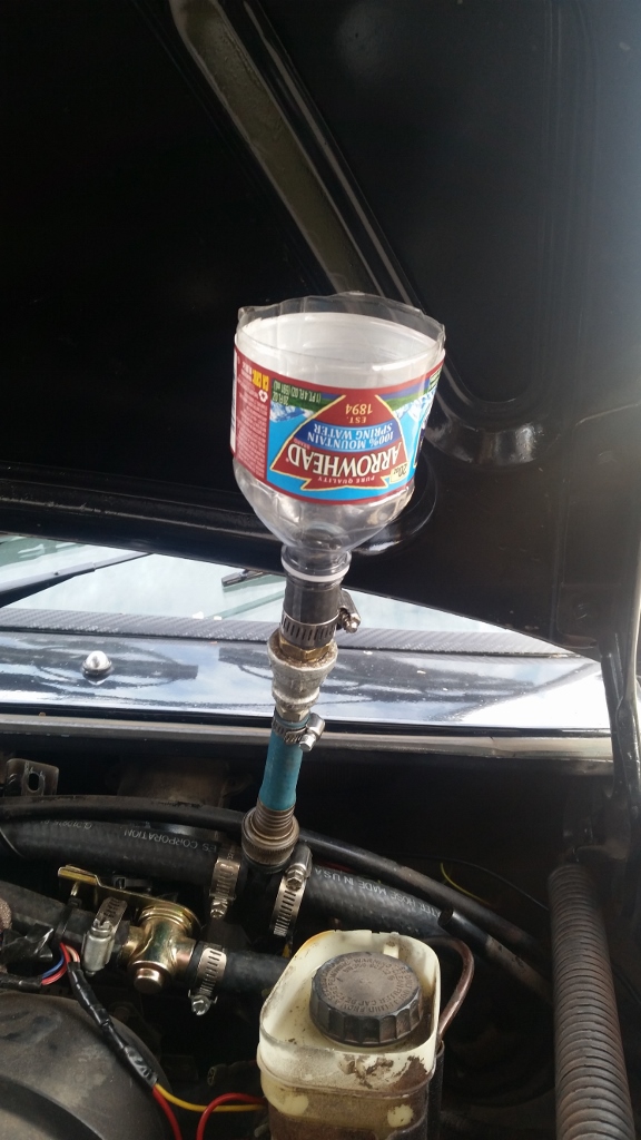

To help get rid of any air in the sytem I am able to fill the system through the "bleeder" near the heater core. I used one of those coolant flush tees with a removable cap and fabricated a funnel to screw on to it.

My funnel/bleeder set up. This way I get a real high point in the system. I put coolant in and squeeze hoses untill it won't suck anymore coolant in.
Kind of crude but it works.

Ive done that with a normal funnel and jesus christ! when the hot water gets to it it starts mixing with the cold water bubbling and popping and over filling the funnel then if i remove the funnel a jet of 200' steam shoots me in the face its mad!..... maybe i should try when its cold. thx for the info on the 4 way valve though (IMG:style_emoticons/default/beerchug.gif)

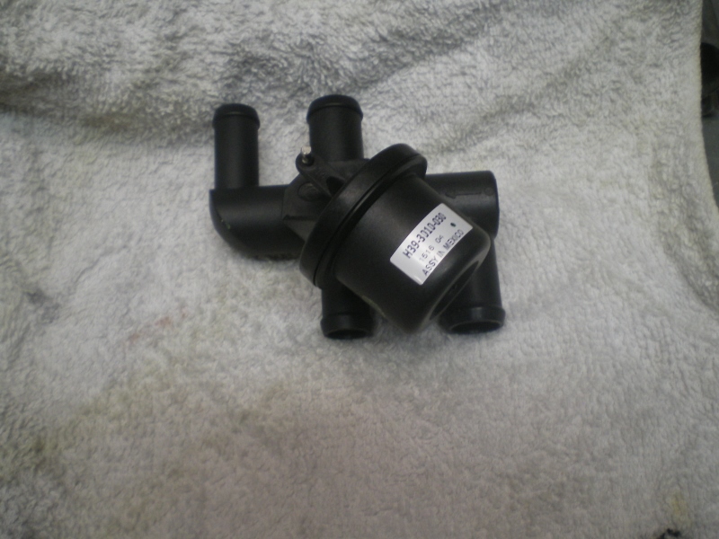

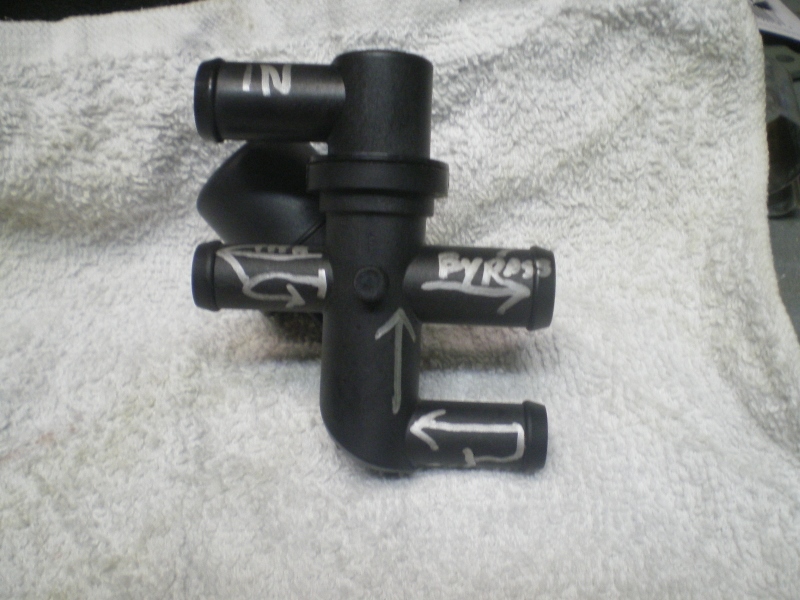

You need one of these:
the other side:
and you should use on of these vacuum reservoirs also: (IMG:style_emoticons/default/beerchug.gif)

Take a pic of your hose routing in the engine bay. Be thorough. Include pic's showing your reservoir and/or expansion tank. Show the high points and low points. A drawing is 2 dimensional and emblematic at best. Where is your bleed located in the front trunk?Did you do the build yourself and this is the 1st overheating problem or did someone else build it and since you worked on it the overheating problem began? Once we get this straightened out you can reconnect your heater but you will need the part shown in my previous response. You can pm me if you need. (IMG:style_emoticons/default/beerchug.gif)
