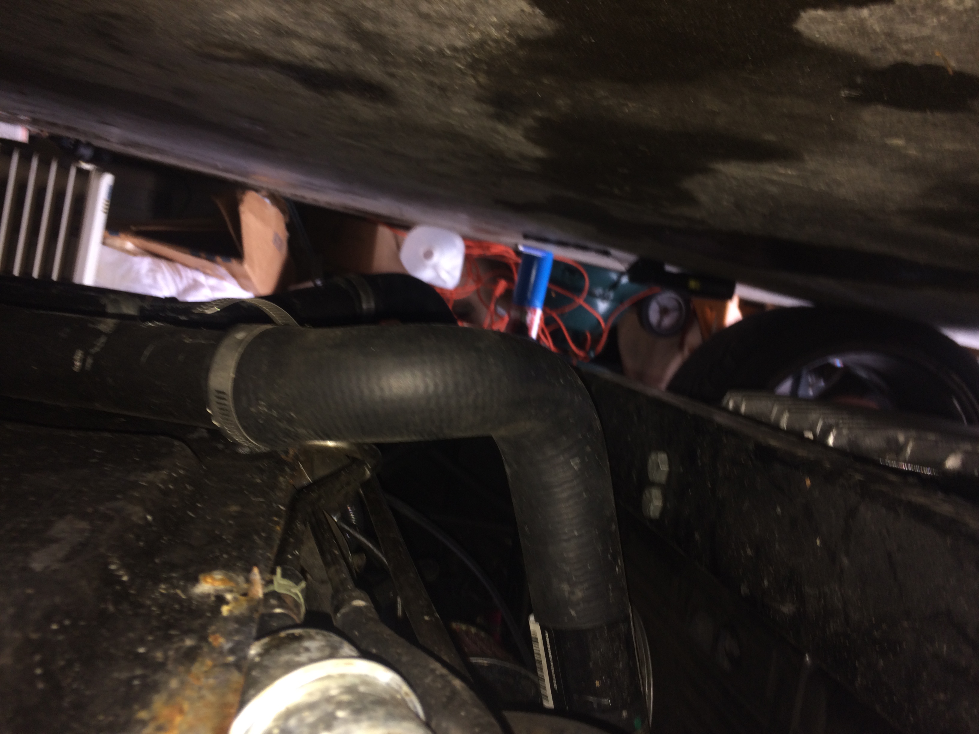

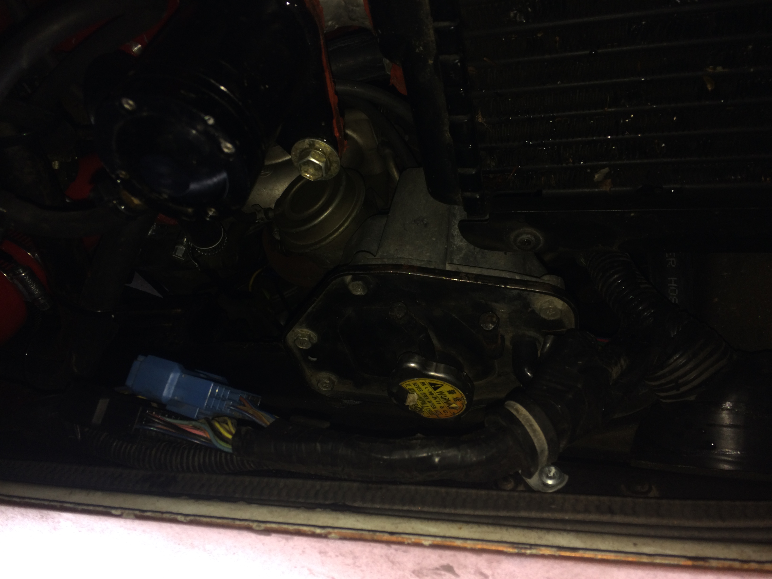

Ok, So, i have an ej205 in my car and until recently ive had just a hose going from one end of the heater pipes to the other. But lately i got the big idea to move to the 20th century and so i added a heater core up front. this meant ~ 20' of 5/8" heater hose (autozone was just thrilled) filled the hoses with water added a bleeder and BAM heat......Or so i thought. My car ran consistently 170-180 now at idle im around 207-208 and it climbs to 230 before im too scared to drive more. ive been attempting to bleed it for three days scolding myself all along they way. What have i done wrong or what can i try, ive been on hills stopped suddenly and swerved hardcore. is it possible that now my car just runs hotter or is there a magic trick for removing air please help!

more picsAttached Image Attached Image

tazz9924   Ok so the hoses r nothing special the go from the ...   Dec 3 2016, 03:28 PM
tazz9924   more pics   Dec 3 2016, 03:29 PM
904svo   Due to the way Subaru operates the thermostat it m...   Dec 3 2016, 04:14 PM
tazz9924   Due to the way Subaru operates the thermostat it ...   Dec 3 2016, 06:31 PM
76-914   Due to the way Subaru operates the thermostat it...   Dec 3 2016, 07:33 PM
tazz9924   [quote name='tazz9924' post='2430031' date='Dec 3...   Dec 3 2016, 10:44 PM
xmotox   hey taz i live in lakewood and would like to sea y...   Dec 4 2016, 12:55 AM
76-914   Take him up on that offer Tazz. Two head are bette...   Dec 4 2016, 08:57 AM
