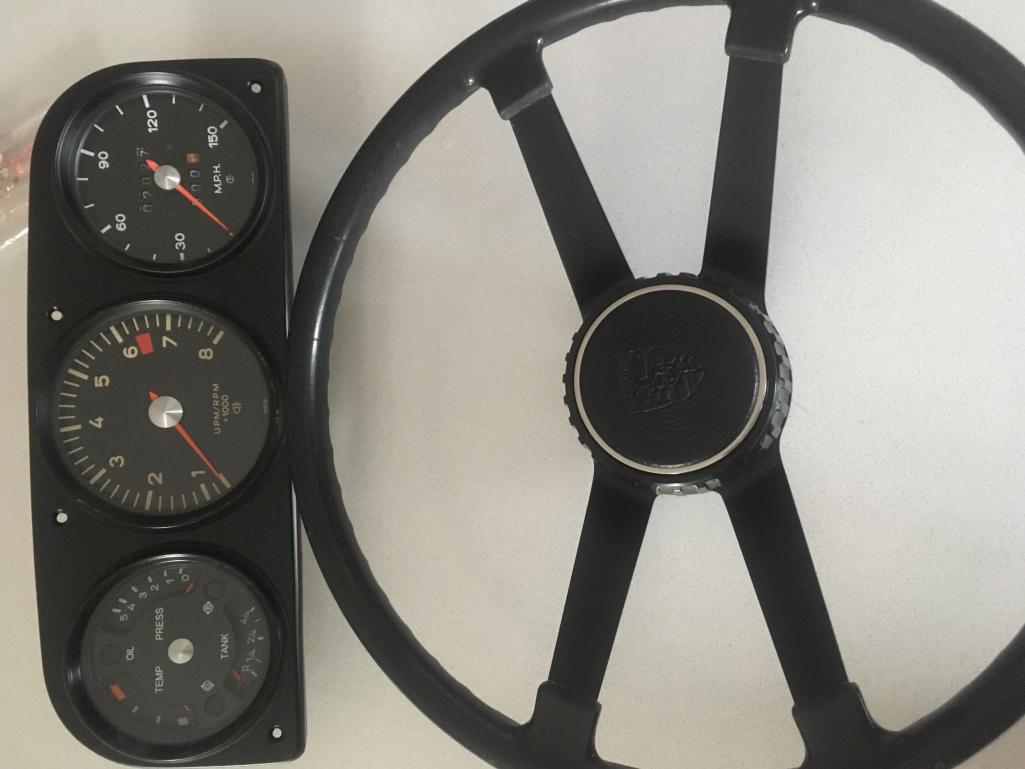

post Dec 4 2016, 06:04 AM
Posts: 139
Joined: 17-August 14
From: Uk Northern Ireland
Member No.: 17,784
Refinished a few components this weekend ...
