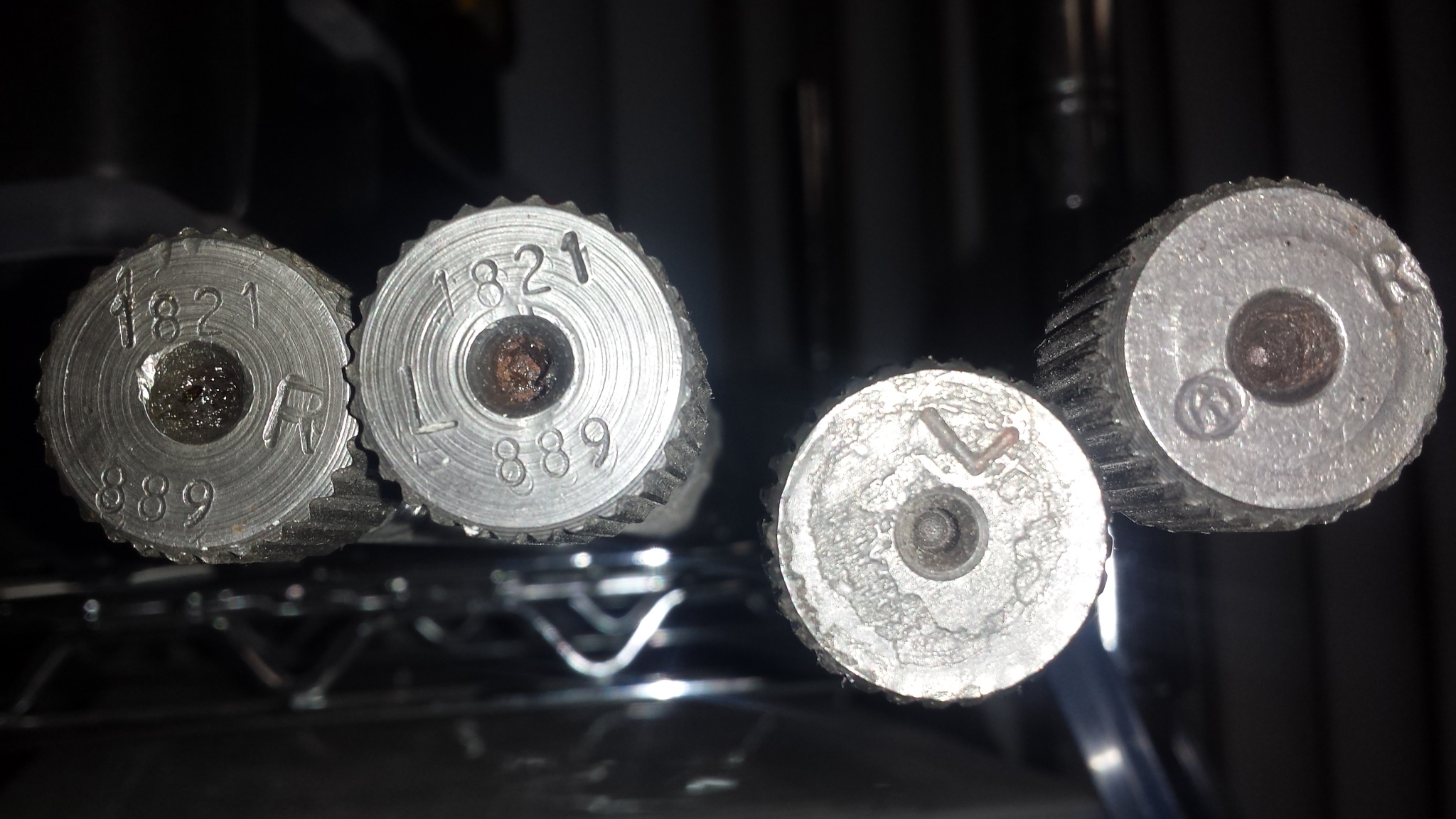

Car has very firm ride in the front,I have Bilstein inserts in Boge struts but the ride is really bone jarring to the point that I have disconnected the swaybar to try and soften it up a little which it did.
Previous to unhooking the swaybar I couldn't even bounce the front of the car with my own weight,needless to say the car isn't that nice to drive (IMG:style_emoticons/default/sad.gif) .
Is there an easy way to check the size,are they marked on the ends? I strongly suspect they are too larger diameter or not setup right (indexing ?) maybe,any helpful suggestions guys,thanks in advance.

Torsion bars are marked on the end. Stock 914 or 911 with an L or R. 914 are rust color and 911 are black. Sway away are marked with a 4 digit group that tell the diameter and type ( 911 or 914) The one pictured are 21mm. I bet that is what you have. The sway bar is not going to make the suspension that stiff.
Thanks Bruce ,great info,realized the swaybar wouldn't make it stiff,but disconnecting it give me some compliance (IMG:style_emoticons/default/dry.gif) .
Bushing were replaced when the front end was upgraded to 5 stud and Brembo 4 pot brakes....according to the PO,I don't distrust him much ,and can see he must forget stuff afterall it was around 1997 when he did the work,I got a great deal on this car.....enough said.
Thanks Tom,will pull it to bits and see ,as you do (IMG:style_emoticons/default/av-943.gif) .
