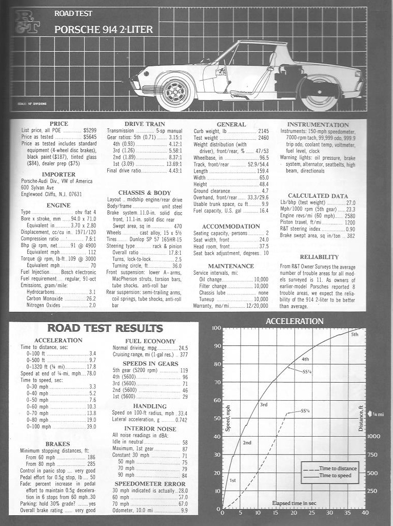

IIRC they were originally stock only 16 mm front & 15 mm rear on both the /4 & -6, or I may have that Bass-ackwards.
FYI - My `73 were stock, Boge struts with classic Koni Sport inserts, lowered an inch & all front bushings replaced back in 1980-83 resto/rebuild, & it rode fine without any harshness nor bump steer.
So maybe the bushings noted above & proprer smaller sized sway bar with smooth yours out? confused24.gif
Here are the back-in-the-day Road & Track spec for my 73 2.0, but it doesn't list the sway/anti-roll bar sizes....
