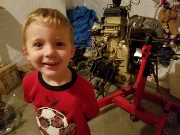

We're finally on the engine stand. More to come....
(Yes thats a plastic monkey wrench hanging off)
