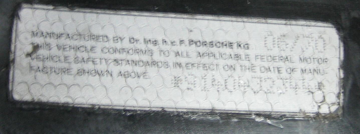

VIN tags look all wrong. No pictures of the VIN in the front trunk. Porsche/Karmann never stamped their numbers that straight. The tags don't look OE. The door jamb sticker is obviously a reproduction.

not only are the vin tag fonts incorrect the dot sticker is a repro with the wrong build date. I don't think they were making 1970 YOM cars in October
here is #2344 for comparison (06/70)

jmill   Did the 70 not have the fender stamped vin?   Dec 19 2016, 07:21 PM
walterolin   Did the 70 not have the fender stamped vin? Yes...   Dec 19 2016, 08:02 PM
KELTY360   :popcorn: So entertaining when this group sinks ...   Dec 19 2016, 07:45 PM
mskala   Yes it should have the fender stamped VIN. Would ...   Dec 19 2016, 08:25 PM
rudedude   10/70 would be a '71   Dec 19 2016, 08:27 PM
rgalla9146   All three identifiers shown are replacements. Th...   Dec 19 2016, 08:47 PM
jmill   All three identifiers shown are replacements. T...   Dec 19 2016, 09:02 PM

Vacca Rabite   The new listing has a pic of the fender VIN stampe...   Mar 12 2018, 05:53 PM
DEC   the VIN of my 6 is stamped the VIN shown in the ad...   Mar 13 2018, 02:49 PM
