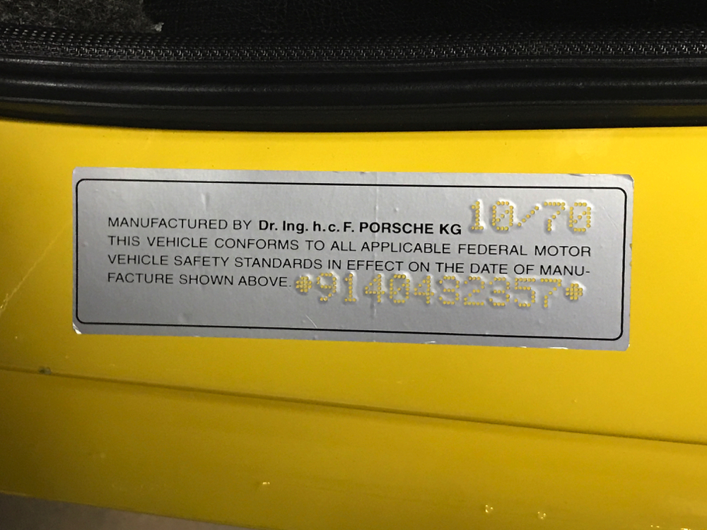

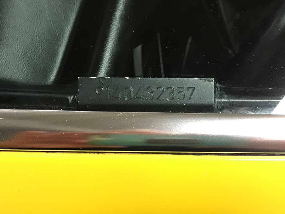

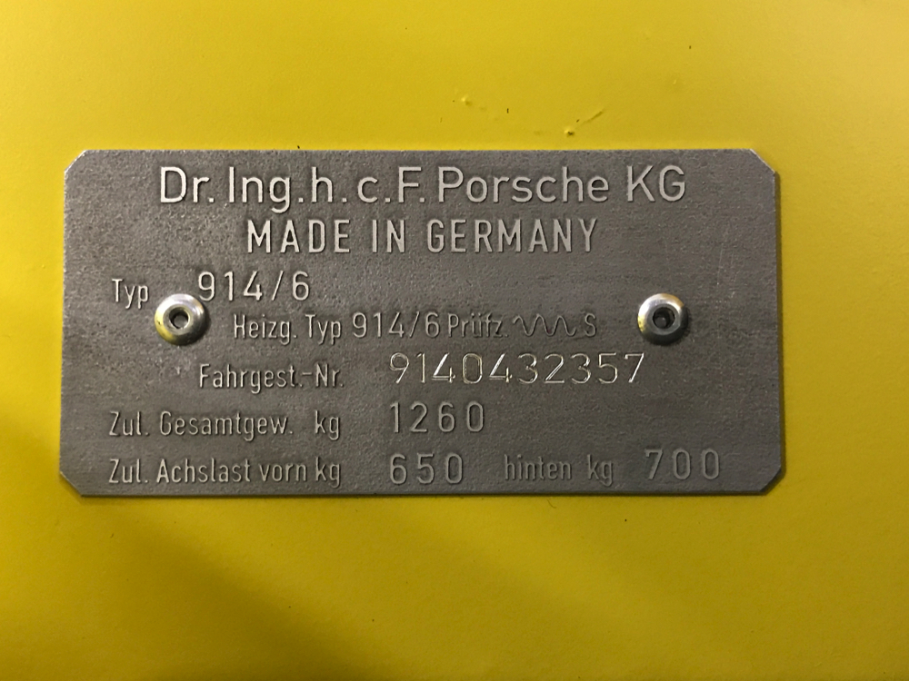

VIN tags look all wrong. No pictures of the VIN in the front trunk. Porsche/Karmann never stamped their numbers that straight. The tags don't look OE. The door jamb sticker is obviously a reproduction.

I'm pretty sure adding a repro VIN tag is not legal in CA and them tags are most certainly repros.
That's a HUGE red flag right there ...

gms   not only are the vin tag fonts incorrect the dot s...   Dec 19 2016, 03:43 PM

rgalla9146   Unsightly hood emblem High polish on Fuchs, ne...   Dec 19 2016, 04:03 PM

North Coast Jim   Windshield VIN tags looks like one from Car Bone i...   Dec 19 2016, 04:39 PM

stugray   The VIN tags dont even look stamped. They look lik...   Dec 19 2016, 05:12 PM

jmill   Did the 70 not have the fender stamped vin?   Dec 19 2016, 07:21 PM
walterolin   Did the 70 not have the fender stamped vin? Yes...   Dec 19 2016, 08:02 PM
KELTY360   :popcorn: So entertaining when this group sinks ...   Dec 19 2016, 07:45 PM
mskala   Yes it should have the fender stamped VIN. Would ...   Dec 19 2016, 08:25 PM
rudedude   10/70 would be a '71   Dec 19 2016, 08:27 PM
rgalla9146   All three identifiers shown are replacements. Th...   Dec 19 2016, 08:47 PM
jmill   All three identifiers shown are replacements. T...   Dec 19 2016, 09:02 PM
