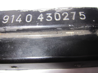

VIN tags look all wrong. No pictures of the VIN in the front trunk. Porsche/Karmann never stamped their numbers that straight. The tags don't look OE. The door jamb sticker is obviously a reproduction.

(IMG:http://www.914world.com/bbs2/uploads_offsite/i68.tinypic.com-11461-1482188258.1.jpg)
The number spacing isn't even right.

gms   not only are the vin tag fonts incorrect the dot s...   Dec 19 2016, 03:43 PM

SirAndy   #9140432357 I'm pretty sure adding a repro VI...   Dec 19 2016, 04:02 PM

stugray   The VIN tags dont even look stamped. They look lik...   Dec 19 2016, 05:12 PM
gcrotvik   The VIN tags dont even look stamped. They look li...   Dec 19 2016, 05:20 PM

jmill   Did the 70 not have the fender stamped vin?   Dec 19 2016, 07:21 PM
walterolin   Did the 70 not have the fender stamped vin? Yes...   Dec 19 2016, 08:02 PM

mskala   Yes it should have the fender stamped VIN. Would ...   Dec 19 2016, 08:25 PM

rgalla9146   All three identifiers shown are replacements. Th...   Dec 19 2016, 08:47 PM
jmill   All three identifiers shown are replacements. T...   Dec 19 2016, 09:02 PM

Vacca Rabite   The new listing has a pic of the fender VIN stampe...   Mar 12 2018, 05:53 PM
DEC   the VIN of my 6 is stamped the VIN shown in the ad...   Mar 13 2018, 02:49 PM
