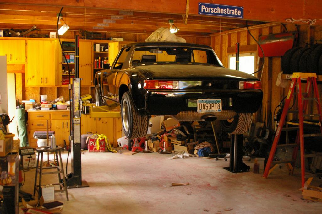

Hey guys (and gals). I know there are some older threads on this, but I am looking for a car lift that can go ~40" lift, doesn't need wooden ramps (for a 914) and doesn't break the bank. This Atlas lift from greg smith seems to come with shipping for $1745. Does anyone have this lift or something similar?

QUOTE(Phoenix-MN @ Dec 8 2016, 06:01 PM) *
Does the Maxjax lift the car high enough to park another 914 underneath? I'm sure the car on top would need the wheels removed for more clearance.
post Dec 19 2016, 07:26 PM
914-6 GT in waiting
Posts: 20,587
Joined: 19-September 09
Member No.: 10,825
QUOTE(ledfoot @ Dec 19 2016, 08:23 PM) *
No
