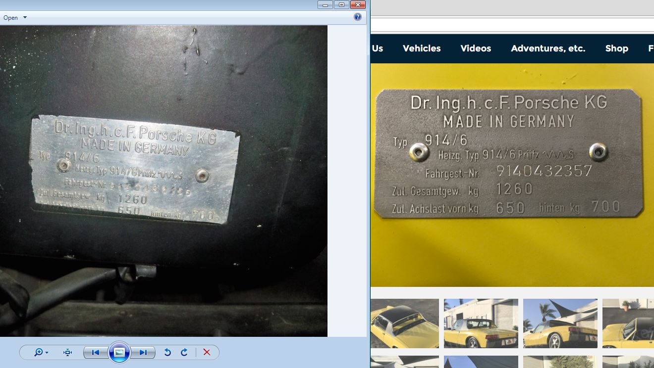

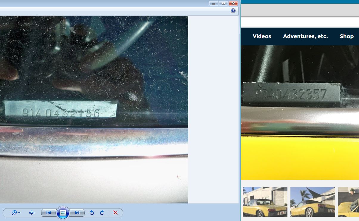

VIN tags look all wrong. No pictures of the VIN in the front trunk. Porsche/Karmann never stamped their numbers that straight. The tags don't look OE. The door jamb sticker is obviously a reproduction.

Those rear fenders are AWFUL. (IMG:style_emoticons/default/barf.gif)
The VINs look illegal. (IMG:style_emoticons/default/stromberg.gif)
I doubt if this car is at his shop. Paul needs to be made aware of the problems pointed out in this thread.

gms   not only are the vin tag fonts incorrect the dot s...   Dec 19 2016, 03:43 PM

SirAndy   #9140432357 I'm pretty sure adding a repro VI...   Dec 19 2016, 04:02 PM

North Coast Jim   Windshield VIN tags looks like one from Car Bone i...   Dec 19 2016, 04:39 PM
Jonathan Livesay   http://www.914world.com/bbs2/uploads_offsite/i68.t...   Dec 19 2016, 04:57 PM
stugray   The VIN tags dont even look stamped. They look lik...   Dec 19 2016, 05:12 PM
gcrotvik   The VIN tags dont even look stamped. They look li...   Dec 19 2016, 05:20 PM
Cuda911   The VIN tags dont even look stamped. They look li...   Dec 20 2016, 04:56 AM

jmill   Did the 70 not have the fender stamped vin?   Dec 19 2016, 07:21 PM
walterolin   Did the 70 not have the fender stamped vin? Yes...   Dec 19 2016, 08:02 PM
KELTY360   :popcorn: So entertaining when this group sinks ...   Dec 19 2016, 07:45 PM
mskala   Yes it should have the fender stamped VIN. Would ...   Dec 19 2016, 08:25 PM
rudedude   10/70 would be a '71   Dec 19 2016, 08:27 PM
rgalla9146   All three identifiers shown are replacements. Th...   Dec 19 2016, 08:47 PM
jmill   All three identifiers shown are replacements. T...   Dec 19 2016, 09:02 PM

Vacca Rabite   The new listing has a pic of the fender VIN stampe...   Mar 12 2018, 05:53 PM
DEC   the VIN of my 6 is stamped the VIN shown in the ad...   Mar 13 2018, 02:49 PM
