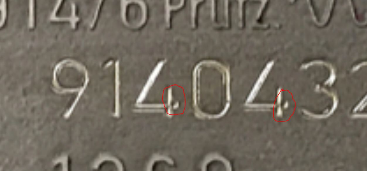

VIN tags look all wrong. No pictures of the VIN in the front trunk. Porsche/Karmann never stamped their numbers that straight. The tags don't look OE. The door jamb sticker is obviously a reproduction.

The VIN tags dont even look stamped. They look like laser etching.
What's with the dimples in the 4s? Clearly not stamped.

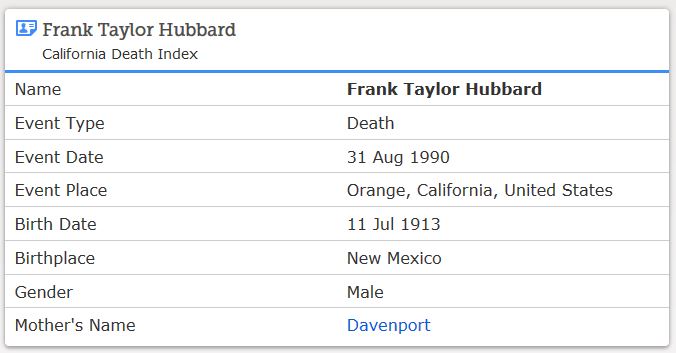

At least we know that in fact Frank Hubbard has indeed passed.
