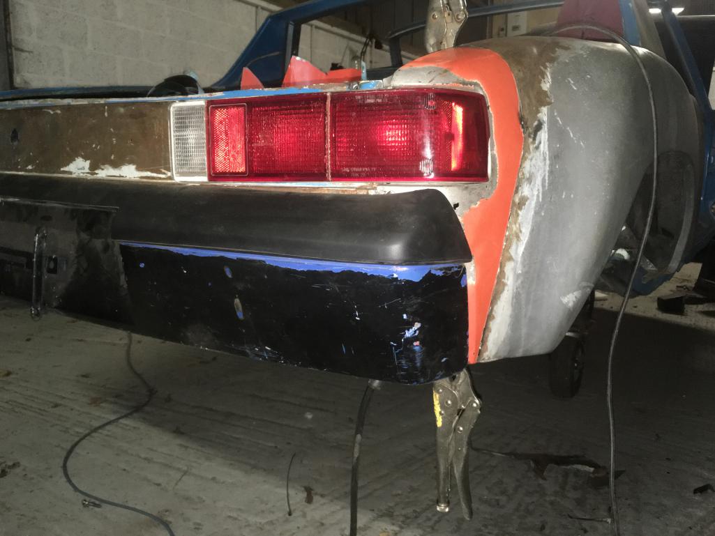

Nutter965   Mmmmmm I think I'm happy, ish, not fully convi...   Dec 29 2016, 04:19 PM
