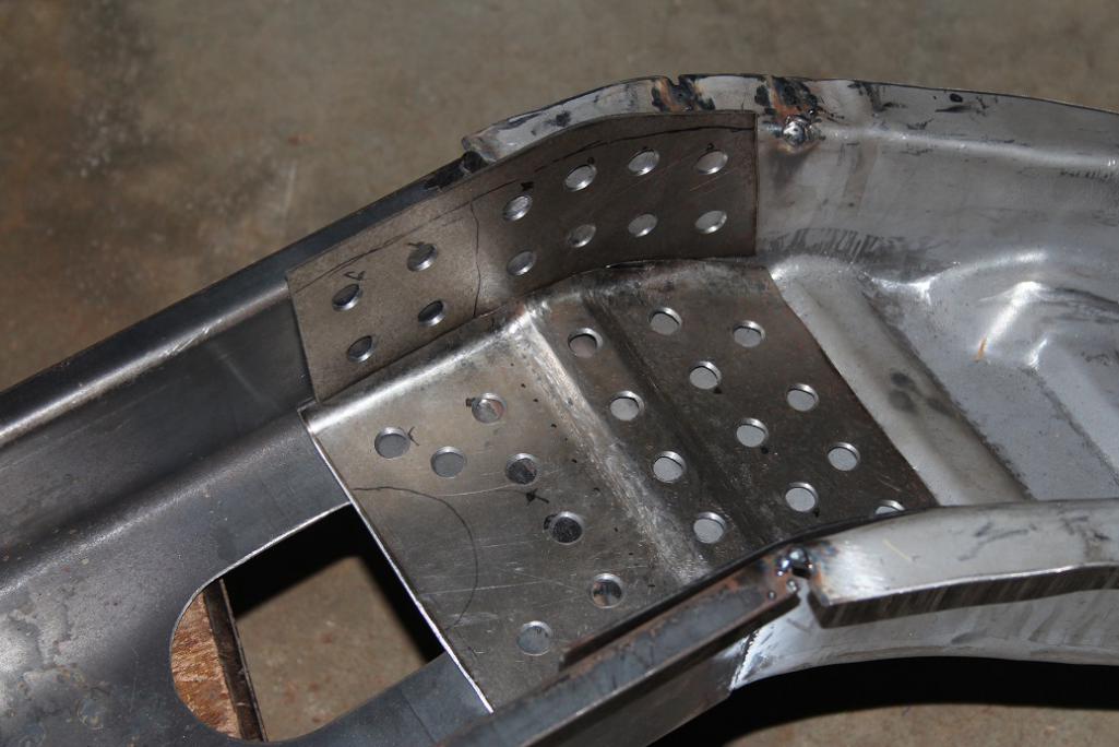

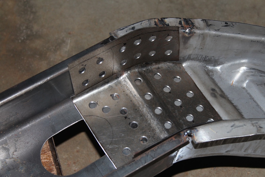

Getting behind on my updates. Got the long sleeved before Christmas...

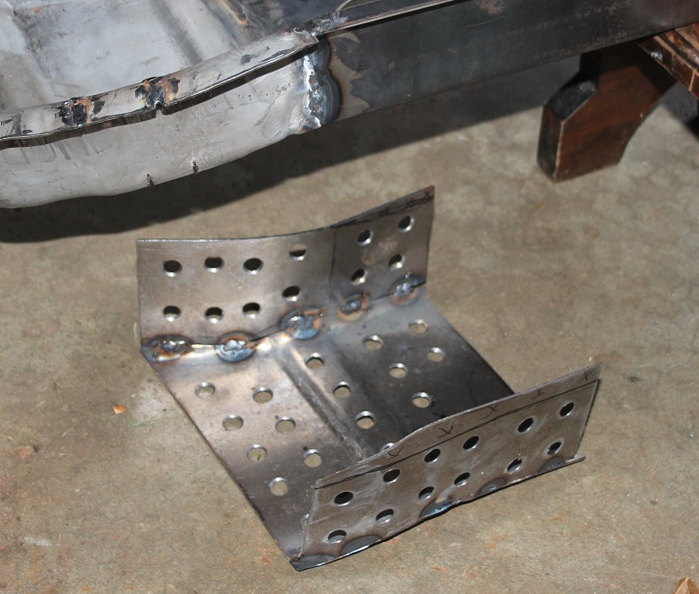

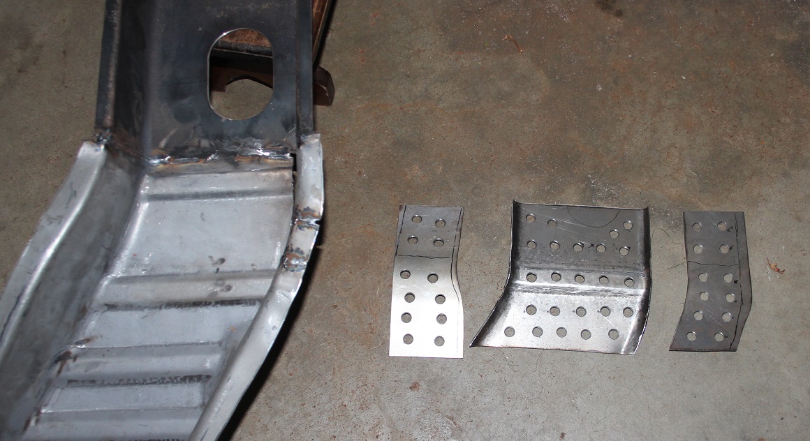

Made it in three pieces from 12g steel (because the long was already fabricated in 12g...) EDIT: sleeve is 14g:

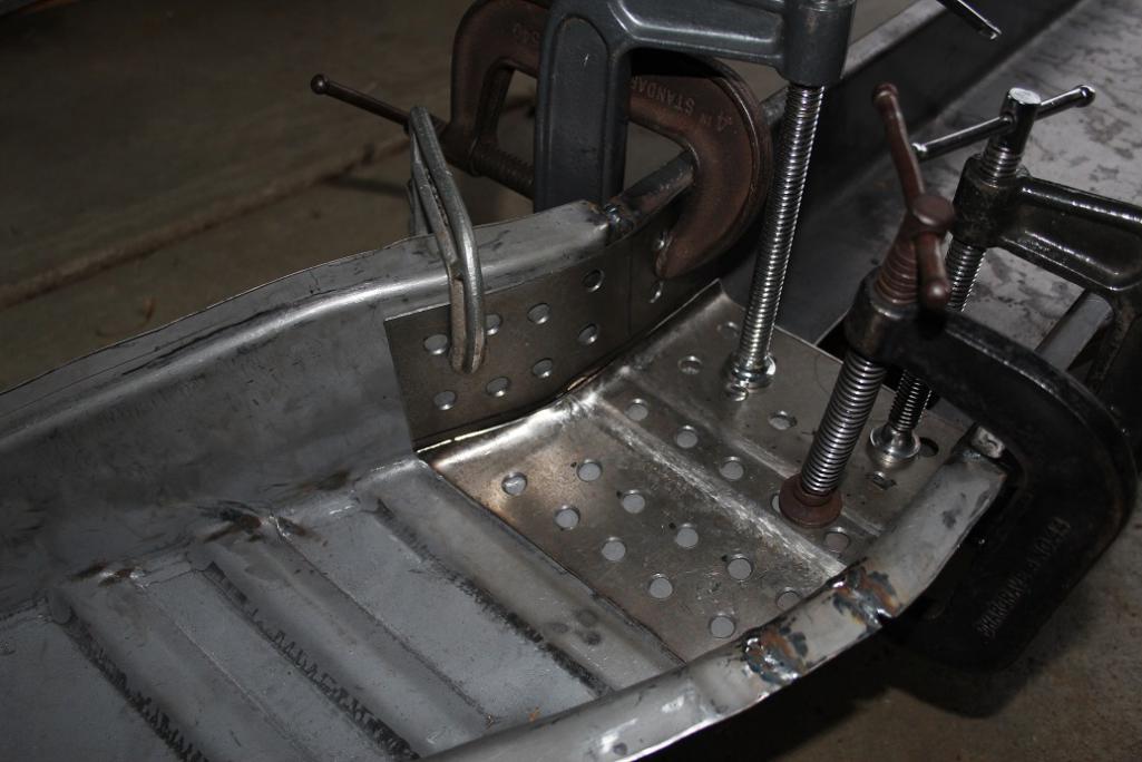

Checking the fit:

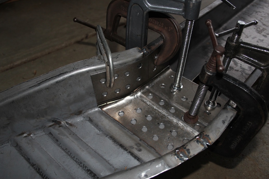

Clamped in place to tack together:
All tacked up:

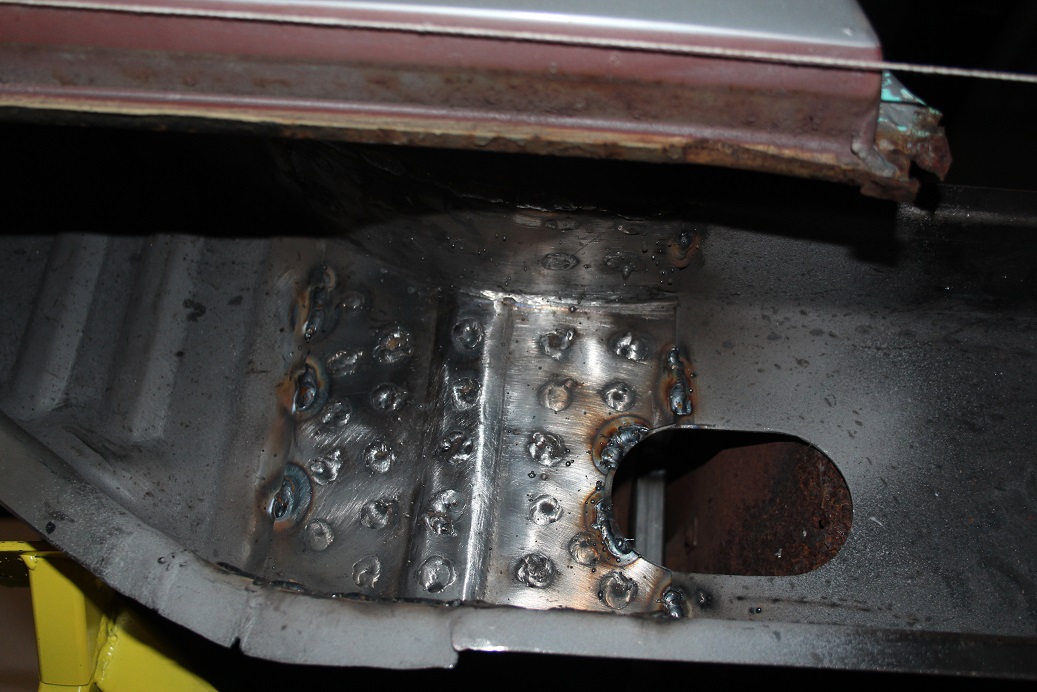

Welded those seams up solid. Did a little trimming, also sprayed on some weld-thru primer to both pieces before the final weld up.
In situ:
