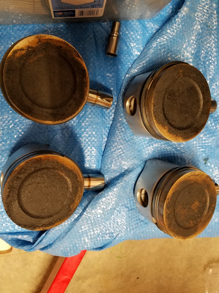

Pistons are off! How do they look?
The clips holding them on were very hard to remove. Splitting the case open tonight! Attached Image

QUOTE(ericoneal @ Jan 3 2017, 09:03 AM) *
Go slowly on splitting the case. Lots of hidden bolts. don't get too physical and try to wedge it apart. If it does not come easily, you have a nut left to get.
If you had low compression, were the rings stuck on that cylinder?
What about a photo of the heads? My problem was obvious. One of the valve seats had broken and gotten into the combustion chamber and bounced around, ruining the piston and the head.
