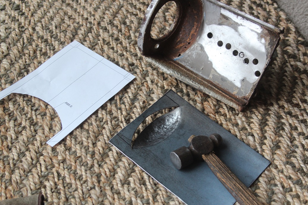

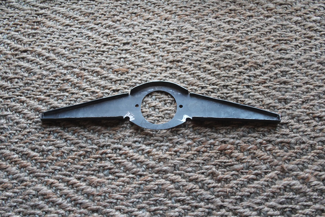

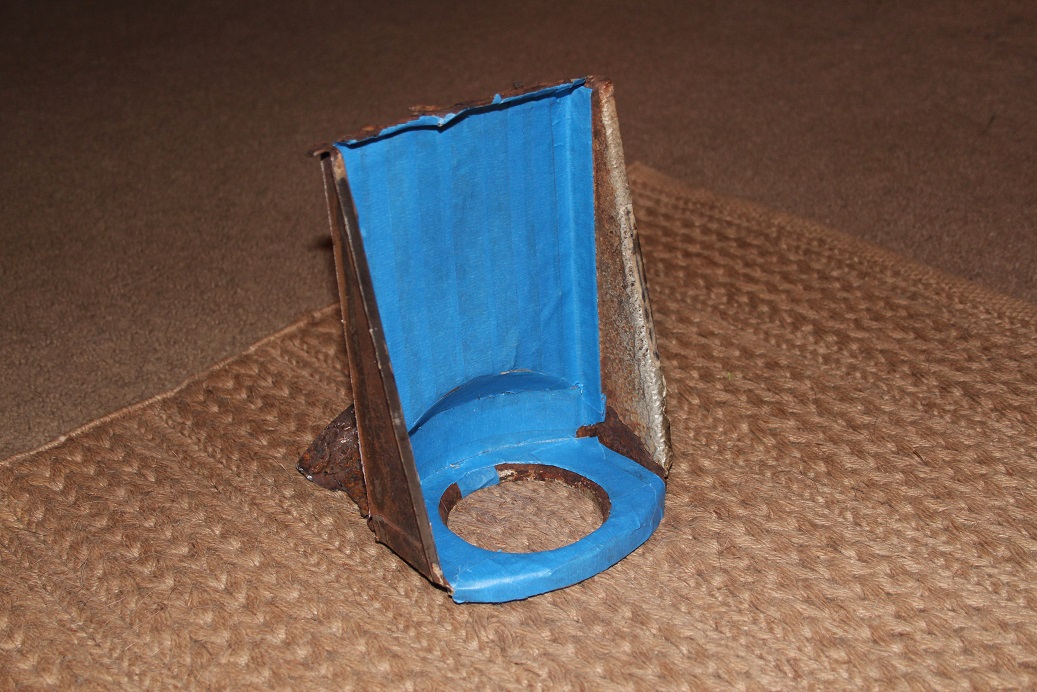

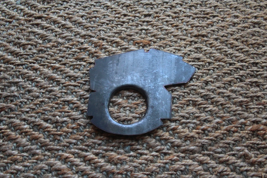

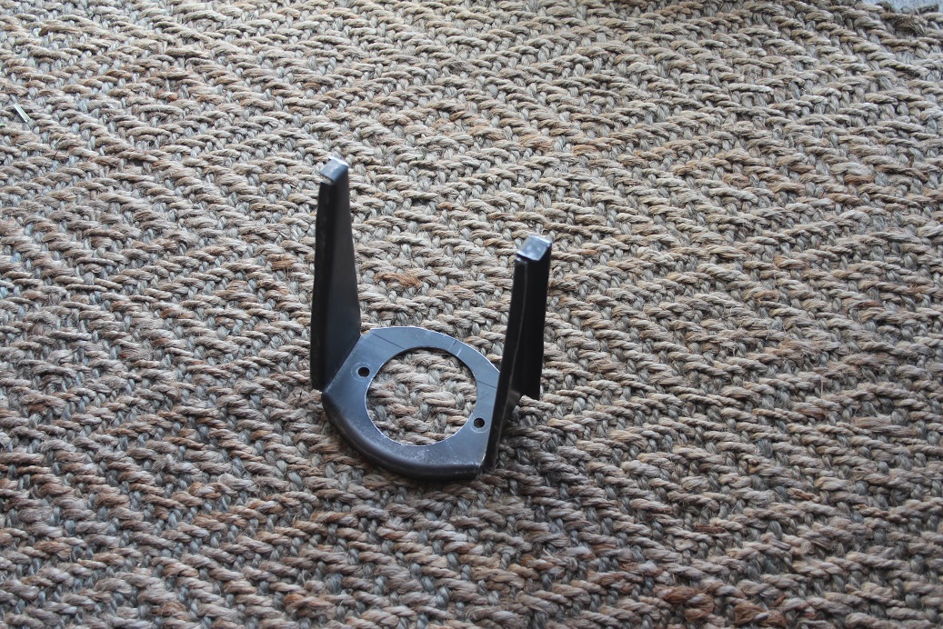

Building a motor mount.

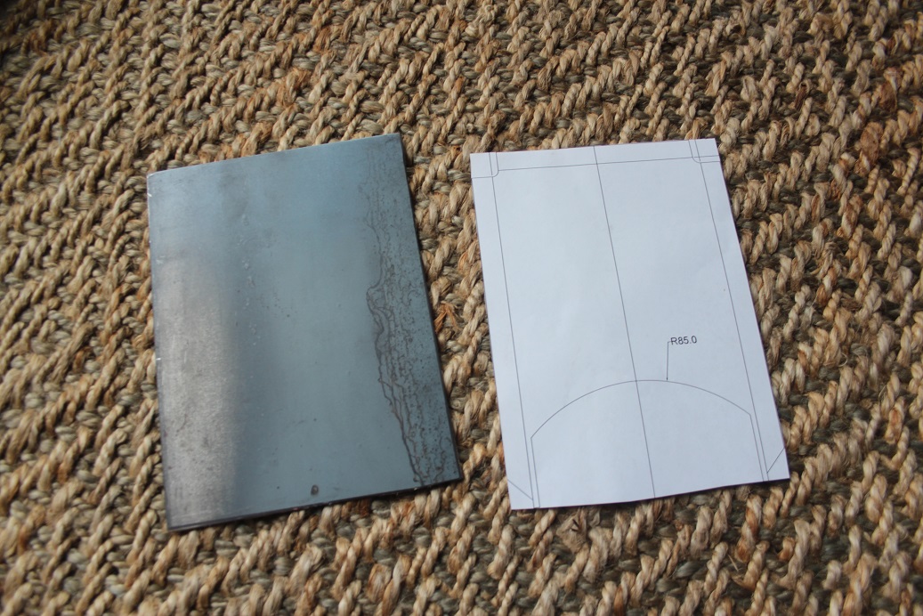

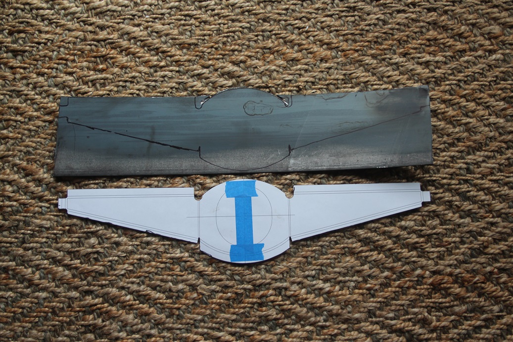

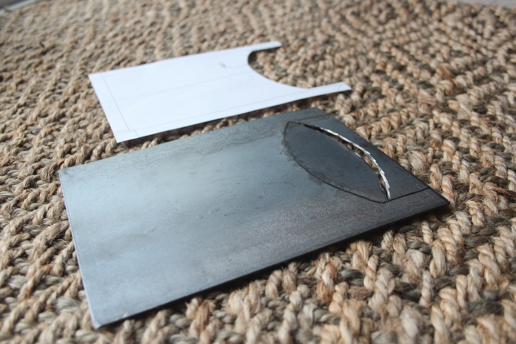

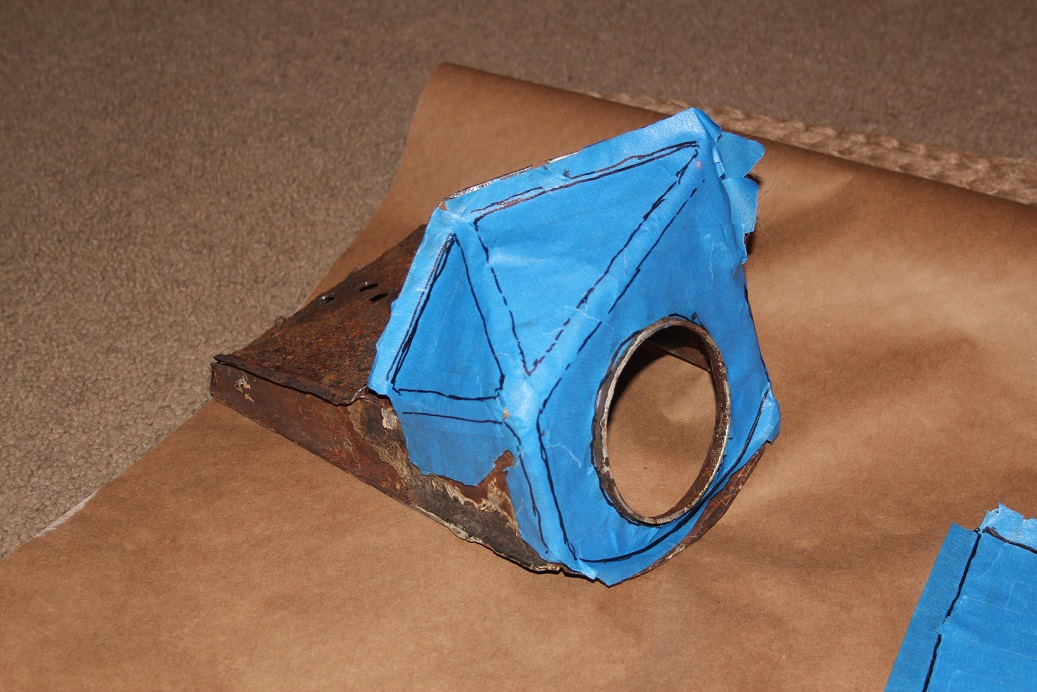

Making a pattern...
Cutting out the pieces...

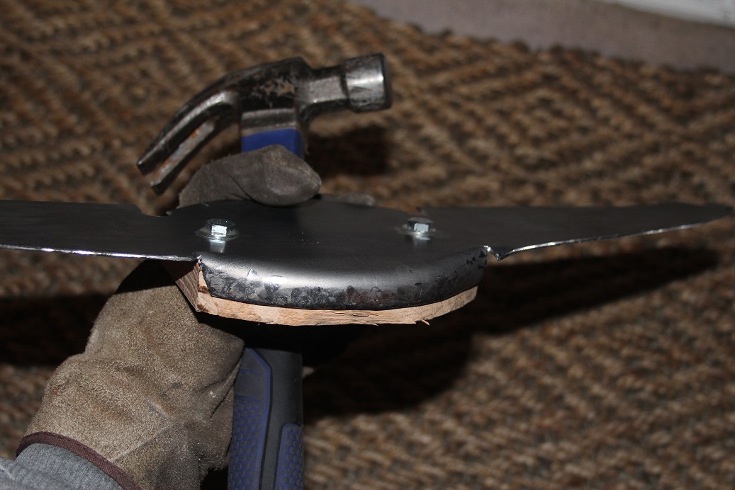

Hammer time...
