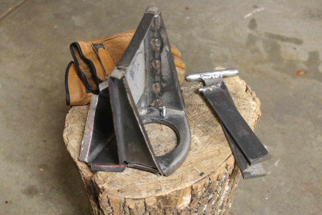

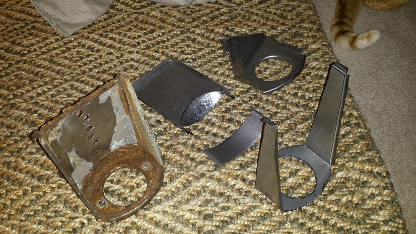

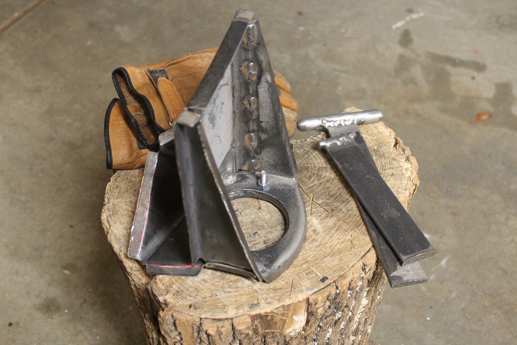

All the bits... These are actually the bits from the light gauge practice piece I made. Can't find a picture of the 14g stuff. Anyway, on to welding...
Welded together. I used weld through primer where there are flanges here. The bottom piece is just bolted to the main part of the bracket, I need to fit it to the long and to my dolly/jig and some bends may need a little tweaking.

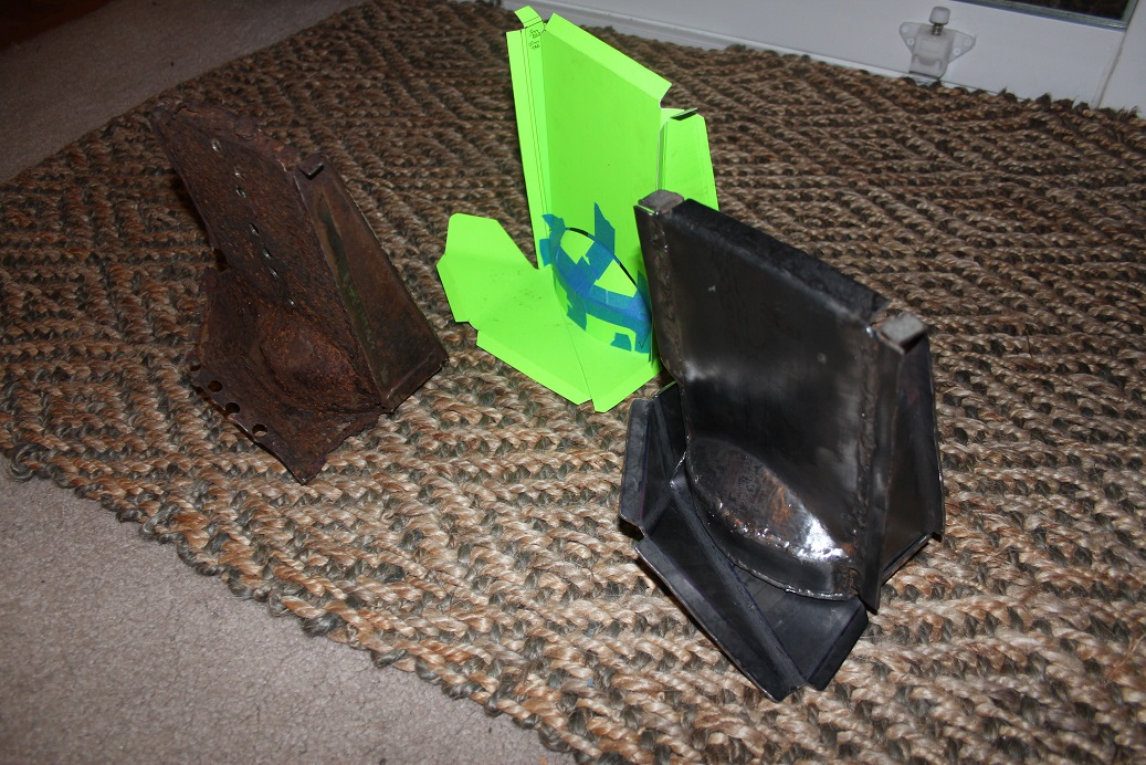

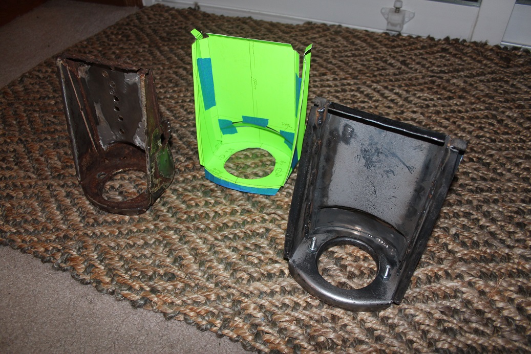

mbseto   Building a motor mount. Making a pattern... C...   Jan 5 2017, 05:14 PM
mbseto   All the bits... These are actually the bits from ...   Jan 5 2017, 05:22 PM
