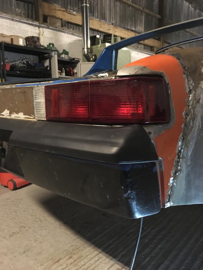

Here's the final fit of the quarter ...
And yes there is a tiny patch needed but it was the best available here !
