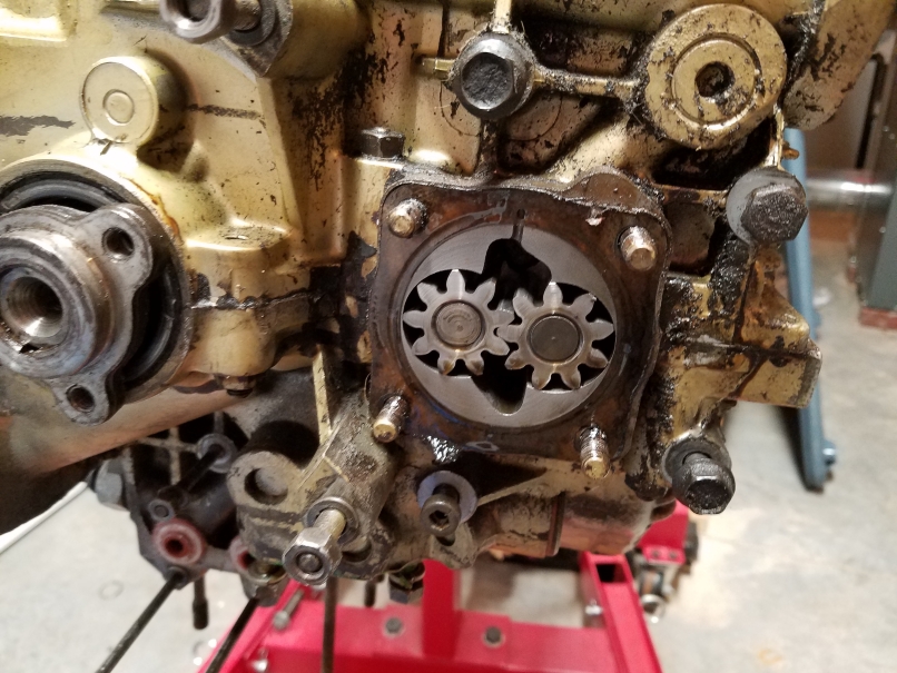

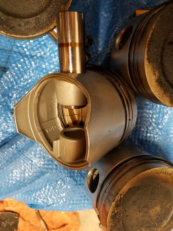

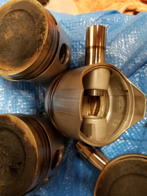

Blake took the thermostat and oil pump cover off last night before the magnets we were going to use to remove the lifters got all of his attention.
This looks like a Type1 oil pump to me, am I right?
Also, can anyone identify these pistons from their markings?
Thanks, slowly making progress..

Al Meredith   Something doesn't look right. All the 1.7s I...   Jan 12 2017, 05:32 PM
ericoneal   I noticed that too, could be bus pistons for sure....   Jan 12 2017, 09:55 PM
