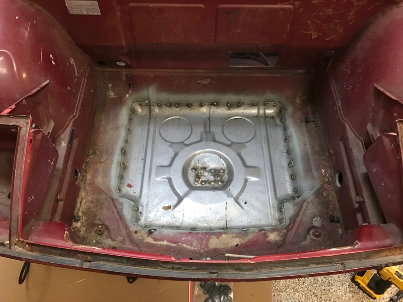

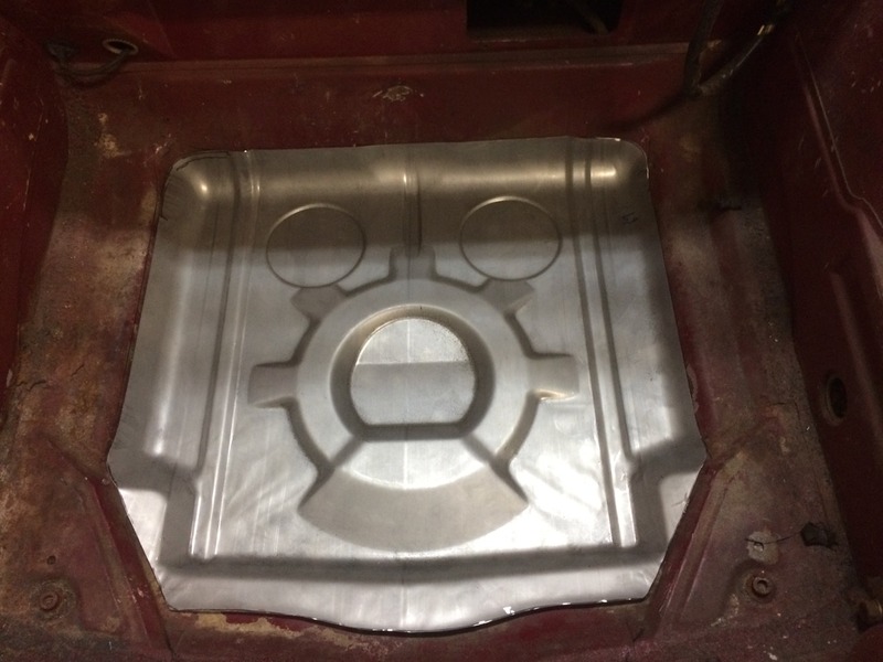

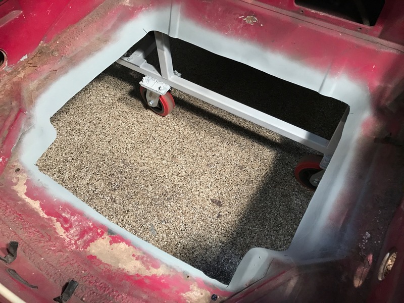

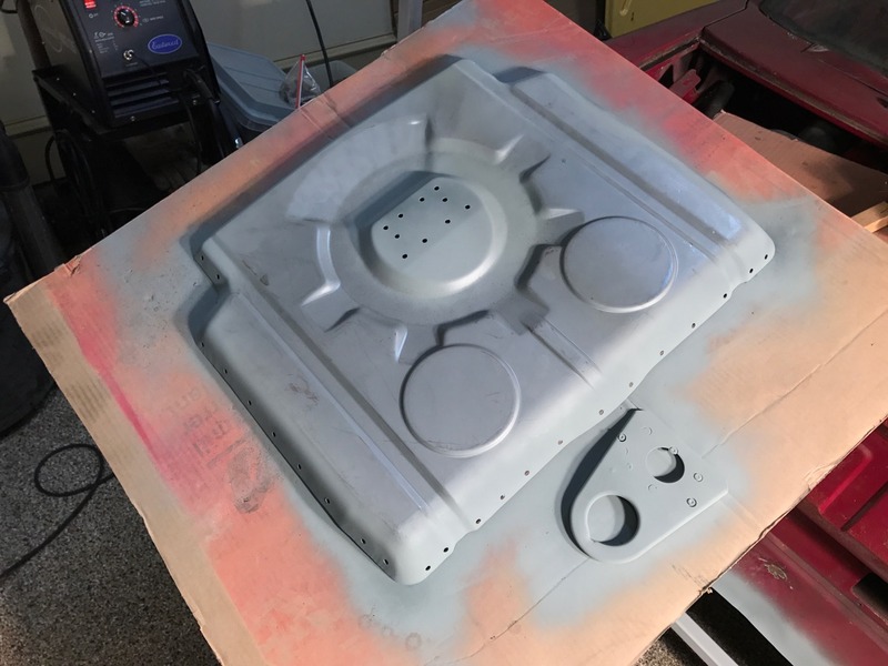

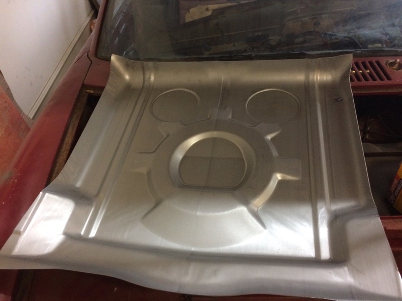

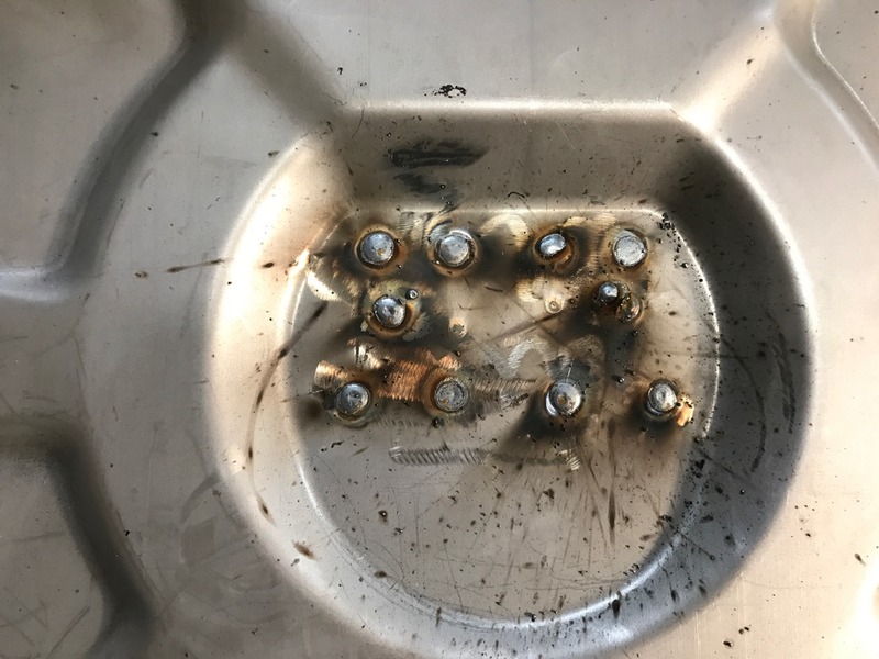

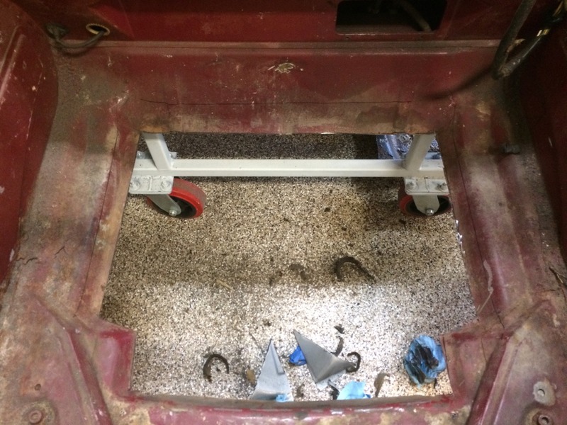

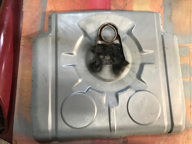

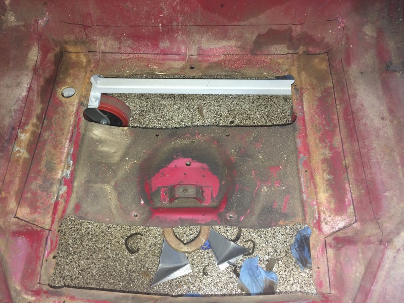

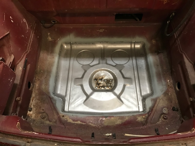

Next up... front trunk floor! The front panel from RD was a very close fit and we had no issues getting it in place after some trimming. Similar to the rear trunk floor, we decided to flange the new metal with the existing and use rosette welds. This will call for seam sealer, but a lot less work than seam welding & grinding. I also salvaged the tow hook and spare tire hold down off of the original floor.
RD Patch Panel:
(IMG:http://www.914world.com/bbs2/uploads_offsite/i120.photobucket.com-19557-1485196551.1.jpg)
Existing mess from aftermarket A/C & sharpie line for rough cut:
(IMG:http://www.914world.com/bbs2/uploads_offsite/i120.photobucket.com-19557-1485196551.2.jpg)
The "final" hole size:
(IMG:http://www.914world.com/bbs2/uploads_offsite/i120.photobucket.com-19557-1485196551.3.jpg)
Cutting to size / Fitting Shape:
(IMG:http://www.914world.com/bbs2/uploads_offsite/i120.photobucket.com-19557-1485196551.4.jpg)
Trunk prepped w/ Zinc Primer:
(IMG:http://www.914world.com/bbs2/uploads_offsite/i120.photobucket.com-19557-1485196551.5.jpg)
Holes Drilled & Prepped w/ Zinc Primer:
(IMG:http://www.914world.com/bbs2/uploads_offsite/i120.photobucket.com-19557-1485196551.6.jpg)
Adding Tow Hook:
(IMG:http://www.914world.com/bbs2/uploads_offsite/i120.photobucket.com-19557-1485196551.7.jpg)
(IMG:http://www.914world.com/bbs2/uploads_offsite/i120.photobucket.com-19557-1485196552.8.jpg)
Fitted & ready for welding:
(IMG:http://www.914world.com/bbs2/uploads_offsite/i120.photobucket.com-19557-1485196552.9.jpg)
All done (minus the spare tire bracket)
(IMG:http://www.914world.com/bbs2/uploads_offsite/i120.photobucket.com-19557-1485196552.10.jpg)
