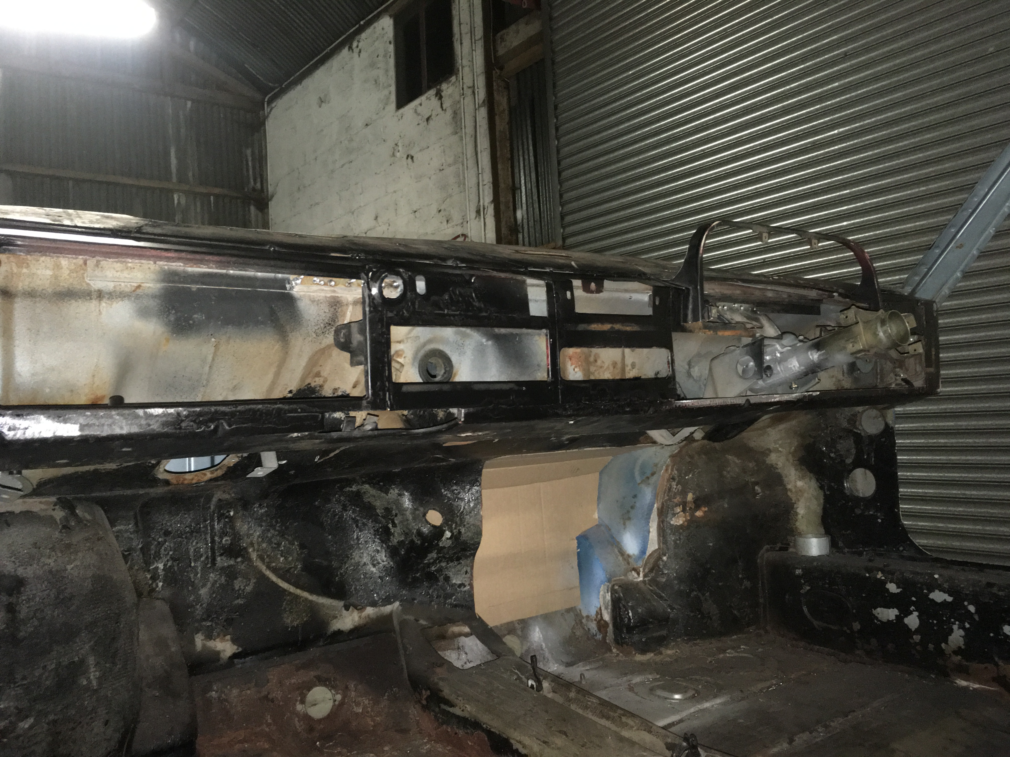

I have been working on the project but it's been a slow cut and weld then re cut and re weld !!
I still have the switch support panels to weld in but here it is a RHD pre vent dash with glove box, radio and ashtray slots !
There is a slight angle/ offset on the column but I can overcome this by slotting the mounting holes .
And yes I had to swap the lock from one side of the glove box to the other as well ...
