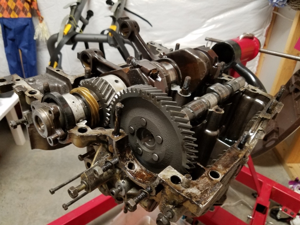

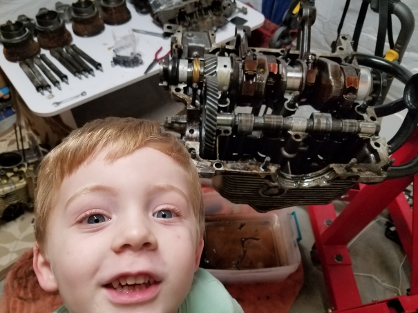

We got the case open!
Confirmed that it is a 1.7 engine, but case has a bronzish tint to it. Wonder if it was recently rebuilt or mucked with because everything has come apart pretty easily. (ie bolts not stuck, etc).
Lots of oil and dirt on it though, so I need to figure out to get this thinged cleaned up. Anyone ever take their case to the car wash and use the pressure washers there?

Al Meredith   Something doesn't look right. All the 1.7s I...   Jan 12 2017, 05:32 PM
ericoneal   I noticed that too, could be bus pistons for sure....   Jan 12 2017, 09:55 PM

Valy   Let me be the first one to tell you that your cam ...   Jan 26 2017, 01:06 PM
ericoneal   Thanks. Valy, I think your right. I'm going ...   Jan 26 2017, 02:38 PM
