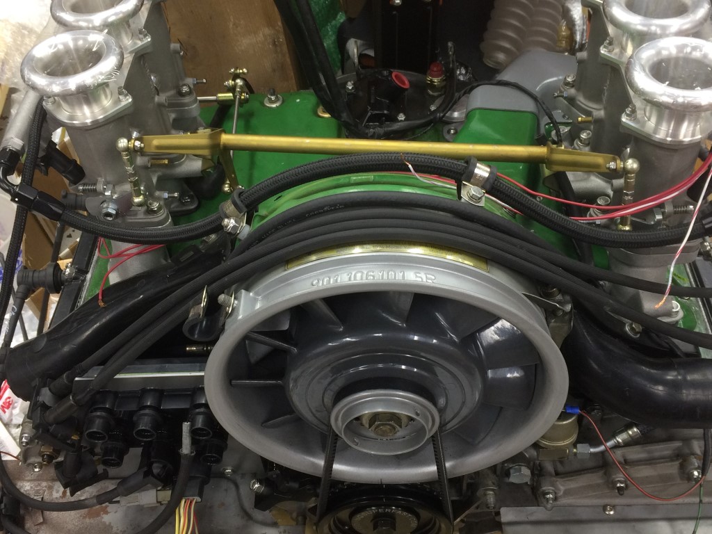

I have started the process of dropping in:
- a rebuilt 2.7S with 9.5:1 forged pistons,
- individual throttle body F.I.,
- distributorless electronic ignition,
- a pair of Ben's 1 5/8" SS HEs,
- a Kennedy Engineering 228mm Stage 1 clutch package,
- a side-shifter trans, and
- Tangerine Racing's complete shift linkage kit with a JWest shifter
I've never taken on a project anywhere close to this magnitude so I'm sure that I will take more time than most to get it all done. I started pulling together the pieces of the project back in August, starting with the engine. Just for my own sake, I'm going to document the steps here because I'm sure that there will be suggestions of how to do things or other items to check that I will not think of and need you guys watching over my shoulder. Unfortunately, there are few teeners around these parts.
My adage just for those wondering, is to do no harm (make no modifications to the car that can't easily be addressed or returned to stock), make it look stock (and/or as period correct as possible), and clean and correct any issues I find as I move along through the project.
Starting with the engine....its a '74 911S that was completely gone through by someone who has done many of these with the correct machining, upgrading to 9.5:1 JE forged pistons and changing the S cams for E cams to make it a better engine for my tastes. I had the builder replace the CIS with ITBs and EFI, managed by a Megasquirt MS3 box with the expansion card. Next, we removed the distributor and replaced the ignition with an EDIS system tied into the trigger wheel and the MS3 ECU for control. He did enough wiring to get it running on his stand but I redid all of the wiring to clean it up and tie it into the factory -6 circuit board, per my adage. I'm going to be using some rainhats to top of the ITBs for now although I may move to a stock air cleaner assembly with a velocity stack on the front. I got a set of Ben's new 1 5/8" SS HE just this last week and have a surprise in the works for the rest of the exhaust.

db9146   When I bought my -6, it had 130K miles and as far ...   Jan 27 2017, 01:17 PM
db9146   Wiring the engine has come in stages as I have tri...   Jan 27 2017, 02:24 PM
db9146   The next item I started working on was the ignitio...   Jan 27 2017, 02:38 PM
db9146   Next, I pulled the alternator to inspect it and de...   Jan 27 2017, 03:02 PM

db9146   Working on the harness for the EDIS and trying to ...   Jan 27 2017, 04:50 PM
db9146   I started work on this a few months ago and its am...   Jan 27 2017, 04:52 PM
