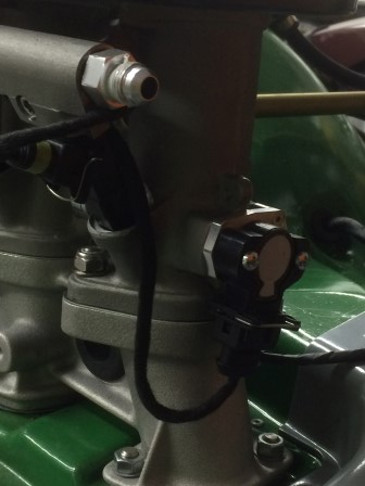

Wiring the engine has come in stages as I have tried to compartmentalize it.
First, was the actual wiring of the FI and sensors on the engine. I followed the MS3X diagrams and tied in one of the oil (coolant) temperature sensors along with oil pressure and air intake temp. All of the ECU connections from the engine will be in one harness that terminate into a single connector for easy engine removal in the future.
Attached Image throttle position sensor
Attached Image intake air temp sensor

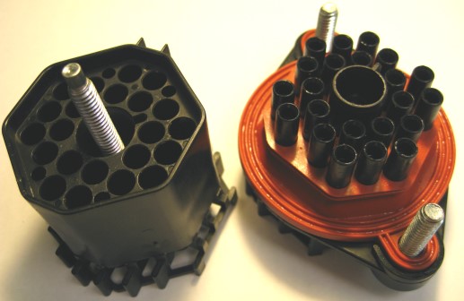

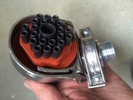

I plan on mounting the bulkhead portion in this aluminum housing since it will mount neatly using an existing stock hole on the passenger side of the engine shelf near the right "hell hole". I looked at other housings and couldn't find anything else that mounted as easily or used existing holes....other than just letting a bare connector rattle around unsupported (not doing that).
Attached ImageAttached Image
This connector will handle everything back to the ECU under the dash.
