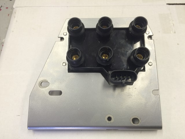

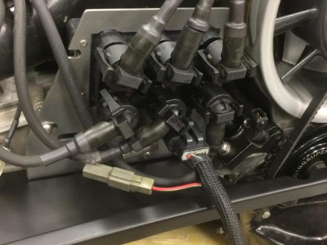

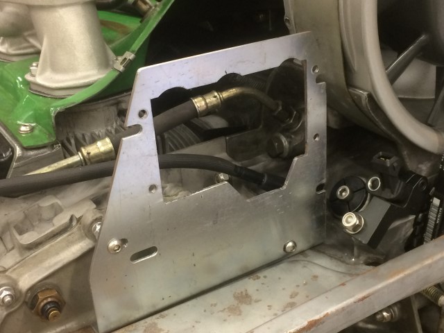

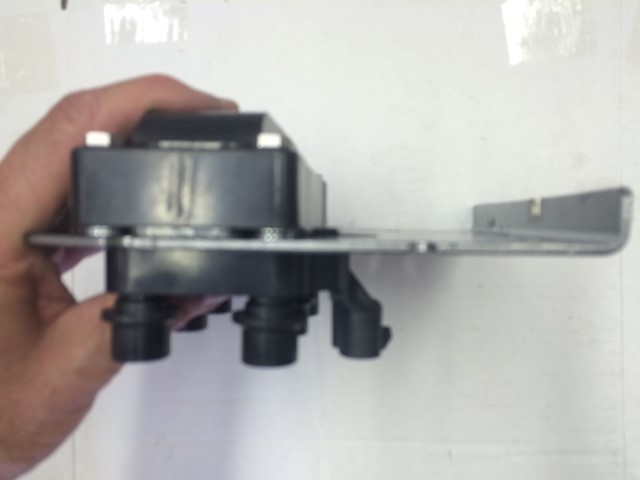

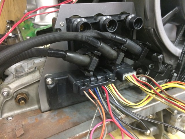

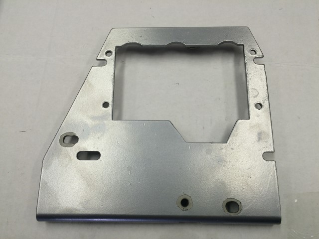

The next item I started working on was the ignition. I'm using a 6 cyl. EDIS set-up with Clewett wires. I made a bracket for the coil module to mount it in the same location as the distributor. The mount is supported by the engine tin screws and some threaded stand-offs back to the cam cover studs but only for vertical stability as the mount has an "L" shape to it to support the weight of the coil and spread it across the shelf along that side of the engine. It came out pretty well, I think...the mount is nice and solid.
I thought long and hard about mounting the ICM (ignition control module) on the same mounting plate just under the coil pack (like the pic below) but after some research, I decided to move it off the engine altogether for EMI and heat reasons.
I reworked all of the Clewett plug wires to clean them up and adjust the length as well.
