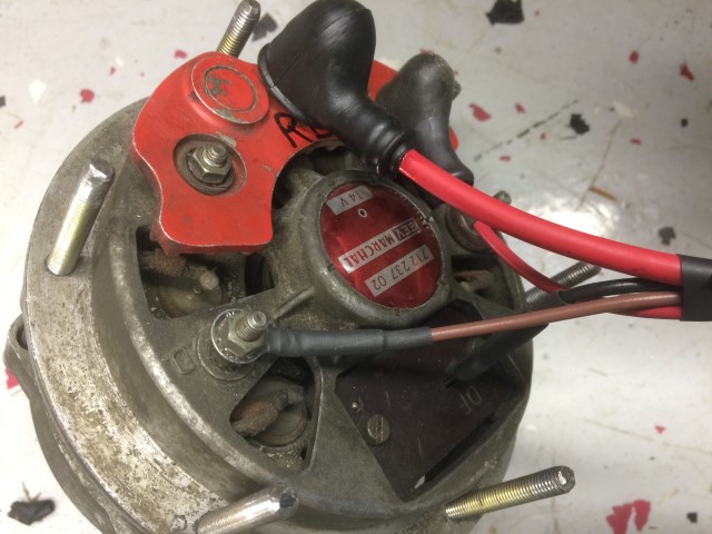

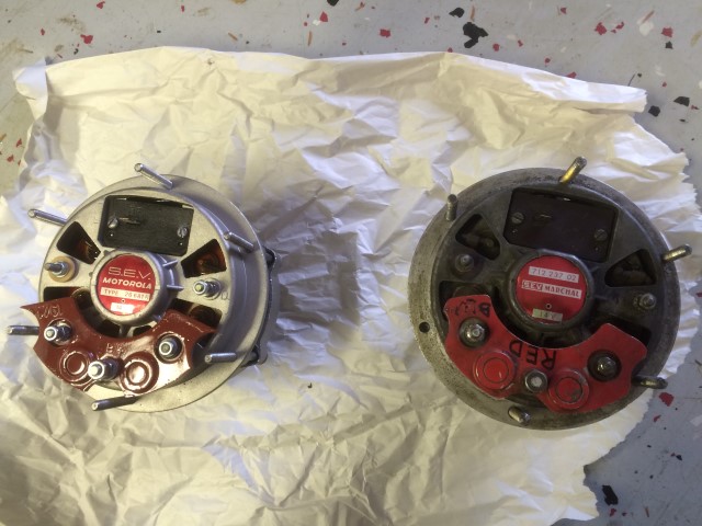

Next, I pulled the alternator to inspect it and decided to replace it with a remanufactured original (with the external voltage reg) from a company in California and an engine wiring kit from Perry Kiehl (thanks again for the kit and the advice Perry!!). I waited to terminate the connections for the 14-pin plug to the stock -6 circuit board and the starter and reverse lights until I have the transmission mounted on the engine. I've been researching a lot to find the right terminals, harness materials, connectors, etc. to make all of the harnesses as bullet-proof reliable as possible....I hate chasing wiring/electrical gremlins.
The old alternator looked like the original unit (dirty and tired).

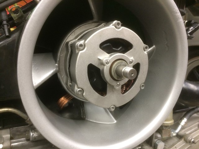

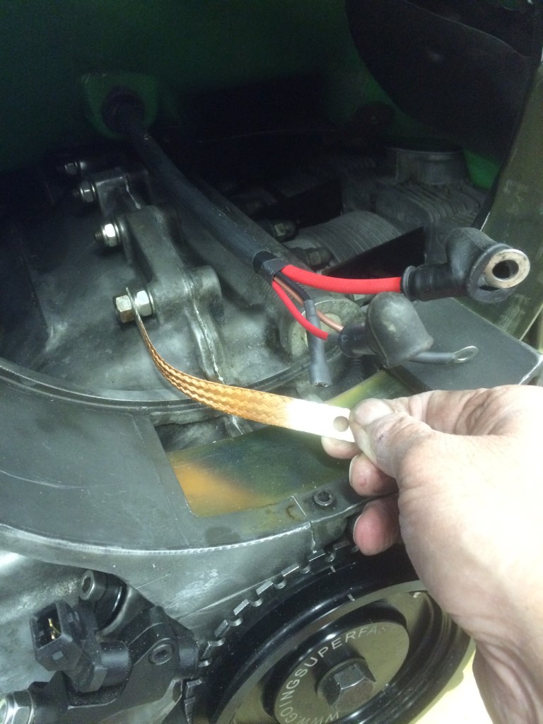

"While I was in there", I sourced the correct air guide (that was in much better condition) for the back of the alternator and installed a new braided ground strap per a Porsche service bulletin of the day (you can just see the new copper strap).

db9146   Next, I pulled the alternator to inspect it and de...   Jan 27 2017, 03:02 PM
