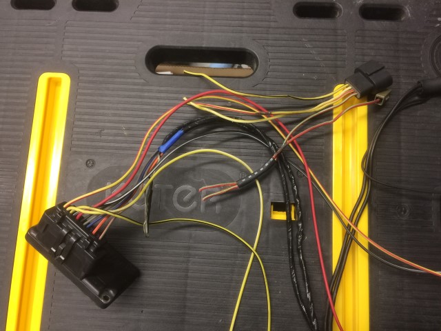

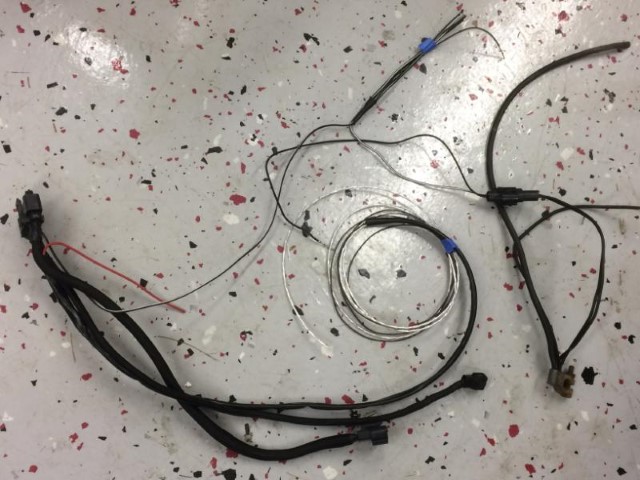

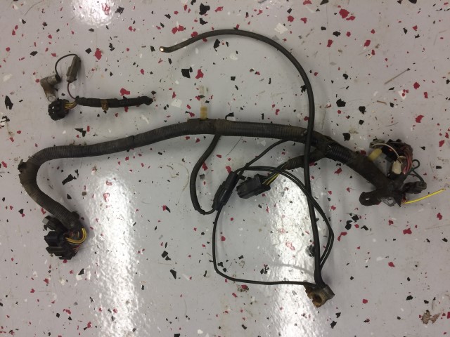

Working on the harness for the EDIS and trying to figure out how best to tie it in for the long haul was fun and yet challenging. I drove over to my nearest Pick-a-Part on two different Saturdays to get sections of wiring harness and then stripped the old tape wrap and cleaned everything. I was able to find a source for the factory ICM 12-pin connector so that I could create my own harnesses to the coil pack, the crank sensor, and to the ECU, that way I got good connections with no splices. I also incorporated the factory radio suppression cap at the coil pack and a grounding diode in the ground path.
Started with this:
and got to this:
and finally to this:
Just have to cut to length and terminate with everything mounted in the car.
