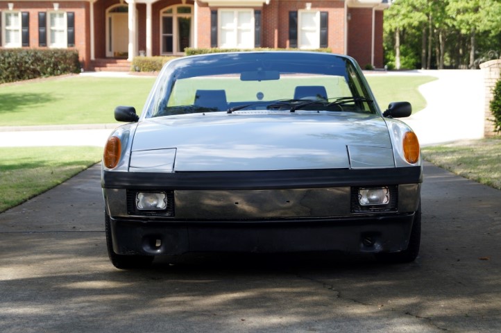

The first 914 I had was a white '76 2.0L. I didn't know a lot about 914s back then (mid 80's) but I came to love that car, despite our ups and downs. Eventually I had to sell it and buy something more practical (I was buying a house and could only afford one car) but I remember reading an article in VW & Porsche magazine about a 914 conversion to a -6. That one was white as well and I started dreaming about one day having a -6.
Well, about a month ago, I was surfing another Porsche site that I don't visit much at all and just on a lark, typed in 914-6 just to see what would come up. To my surprise, I found a silver 1970 for sale near San Francisco. I finally reached the seller and started a conversation. I then reached out to the board here for a PPI and Matthepcat responded and very graciously offered to take a look for me. Well, things progressed with the seller and not wanting to let it get away, I made arrangement to skip the step 1 visual PPI that Matt offered to do and jump straight to step 2, a professional PPI with a compression check and the whole bit. A few more conversations and it was mine. There was money to wire and forms to FedEx back and forth but on my drive up to the Hershey swap meet a little over a week ago, it all came together. My wonderful wife was working out the transfer at the bank while I was driving up through Virginia. To cut to the chase, it got delivered yesterday.
Attached Image Attached ImageAttached ImageAttached Image[attachmentid=498
632]Attached ImageAttached ImageAttached Image[attachmentid
=498636]
I know you guys especially can understand the excitement about this....I'm not bragging at all just very thankful that it has all worked out this way after dreaming about this for 30 years.

QUOTE(ThePaintedMan @ Jan 27 2017, 05:47 PM) *
Nice work! Pretty car. Can I make one small request? With all the mechanical work you're going through, can we get those fog lights replaced with the correct ones along with the grills? (IMG:style_emoticons/default/biggrin.gif)
Thanks for the compliment but I kinda like the square fog lights in the bumper. They're different and fit with the "squareness" of the bumper. I'm looking for some square LED foglights to match the rest of the exterior lights that have all been converted to LED. I'm going to pay close attention when mounting them to make sure their centered and the modify the grills to fit.
Attached Image (with old spoiler)
But don't worry, I have a set of NOS grills and a set of 914Rubber's latest for when my son converts it all back to stock when I'm long gone!
