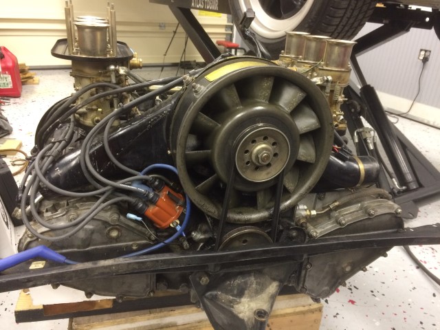

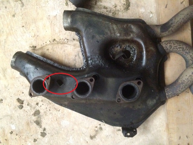

A couple of weeks ago while my son was home from college, he and I pulled the stock 2.0 -6 and tailshifter trans. Once I got the disconnected everything from the top, we moved underneath and pulled the shifter linkage, oil lines, and stock heat exchangers. I thought they were in pretty good shape until we got them off and I found out that the metal tab near the #1 exhaust port had torn a hole in the top of the HE about the size of a quarter.
With a pallet placed on top of a furniture dolly, we positioned it under the engine/trans and used an assortment of wood and 1.5" styrofoam blocks to support both equally well. I then lowered the car the last 1" until it touched down, pulled the three bolts, and lifted the car off the engine with the Atlas 6000 lift. Wow, worked like a charm!
Here's a pic of the engine as it came out:
Attached ImageAttached Image
You can tell it's tired, huh?
