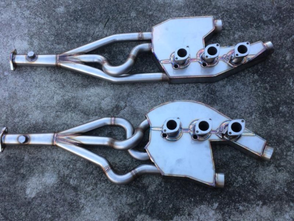

Hi Ben,
Yes you did and they are beautiful. I have an Innovate Motorsports LC-2 WB O2 sensor I'm going to be plugging into one of the bungs and feeding the MS3X.
The rest of the exhaust is going to be surprise!!
