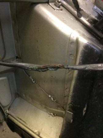

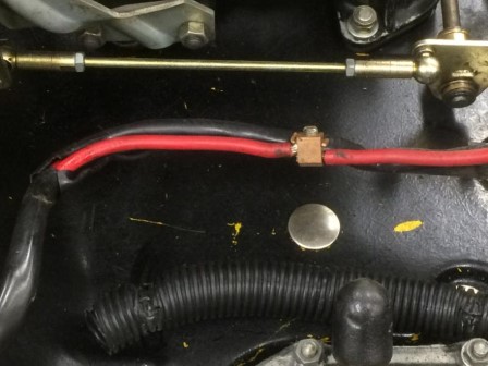

For one, there was a separate, heavy duty ground cable from one of the starter mounting bolts all the way back to the negative battery terminal in addition to the stock ground strap on the back of the trans up to the stud on the underside of the trunk floor. Another "interesting" issue I found on the original 2.0 once I had it out and was checking it over was this splice in the alternator output lead back to the starter.

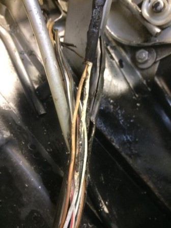

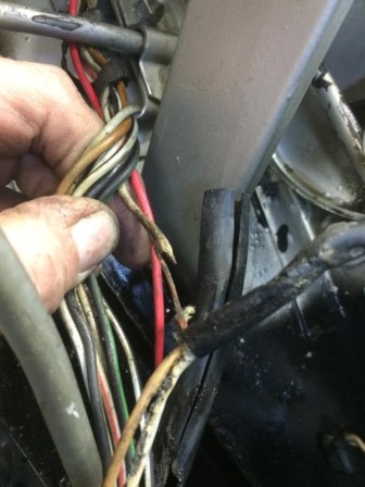

When I was looking over the wiring harness through the engine compartment back to the light in the trunk and the tail lights, I found an area on the PVC sleeve covering that was a bit "crunchy". I continued on up towards the trunk light and found more of the same.
Attached ImageAttached ImageAttached Image
So I went back to a spare wiring harness I have and cut out the wiring for the rear trunk light, cleaned it up, and spliced it back into the harness and then wrapped the harness again.
