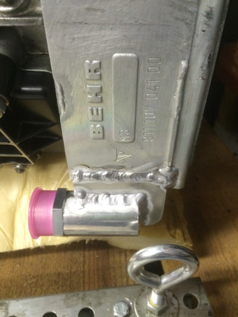

Actually, that was one of the considerations for choosing the engine I did. I didn't want to have to cut the front trunk for a cooler or other areas for oil lines so I tried to pick an engine that would make it more fun to drive w/o adding an aux. cooler.
The other reason I had for going with the 2.7S is because for me, it seemed a better fit for the kind of experience I am looking for.
When I got the engine (which had just been rebuilt), there was a tremendous amount of crud in between the fins of the cooler which I'm sure would have affected cooling. So since I needed to modify the 911 oil cooler to work in the 914, I cleaned it really well by plugging the inlet and outlet and soaking it in carb cleaner as the first step. Once it was really clean, I sent it out to Rich Johnson to have him do the -6 oil cooler mod and then pressure test it. Now its like new.

When I got the engine, I cleaned it really well and then sent it out to Rich Johnson to have him do the -6 oil cooler mod and then pressure test it. Although the engine was rebuilt, the oil cooler still had a lot of crud in the fins that I'm sure would have affected the cooling.
good deal and yes all that grim really afects cooling.. look into the bruce anderson cooling fins mod and how to cut them for better affect good luck nice hot rod
