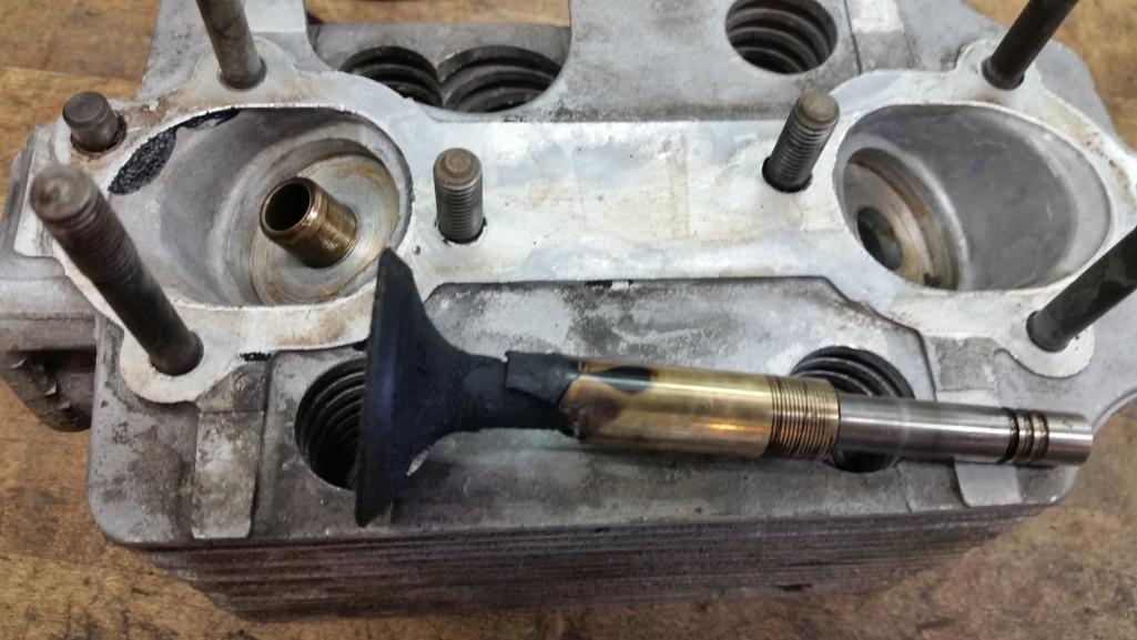

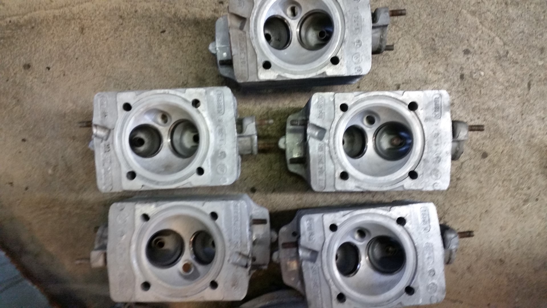

Got word on my engine....my wallet is going to take a huge hit:
Heads have issues and need to be machined along with new guides and valves. One cyl head will need to be either replaced or have a custom valve guide made to fit (see photos!). The cylinders are not as round as they once were so we're going to have to go with coating my stock alusil cyls with nickasil coating and some 9.5:1 pistons.
So I'll have to get a new cam to take advantage of the better flowing pistons with valve releifs.
It's going to be $$$$$, but it's going to be sooo good when done (that's what I keep telling myself).
