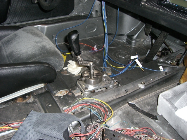

brant   here are some:   Jan 31 2017, 10:48 AM

barefoot   Here's a selection for us CSOB types: https://...   Jan 31 2017, 04:27 PM
Mark Henry   My linkage mod :)   Jan 31 2017, 04:38 PM
