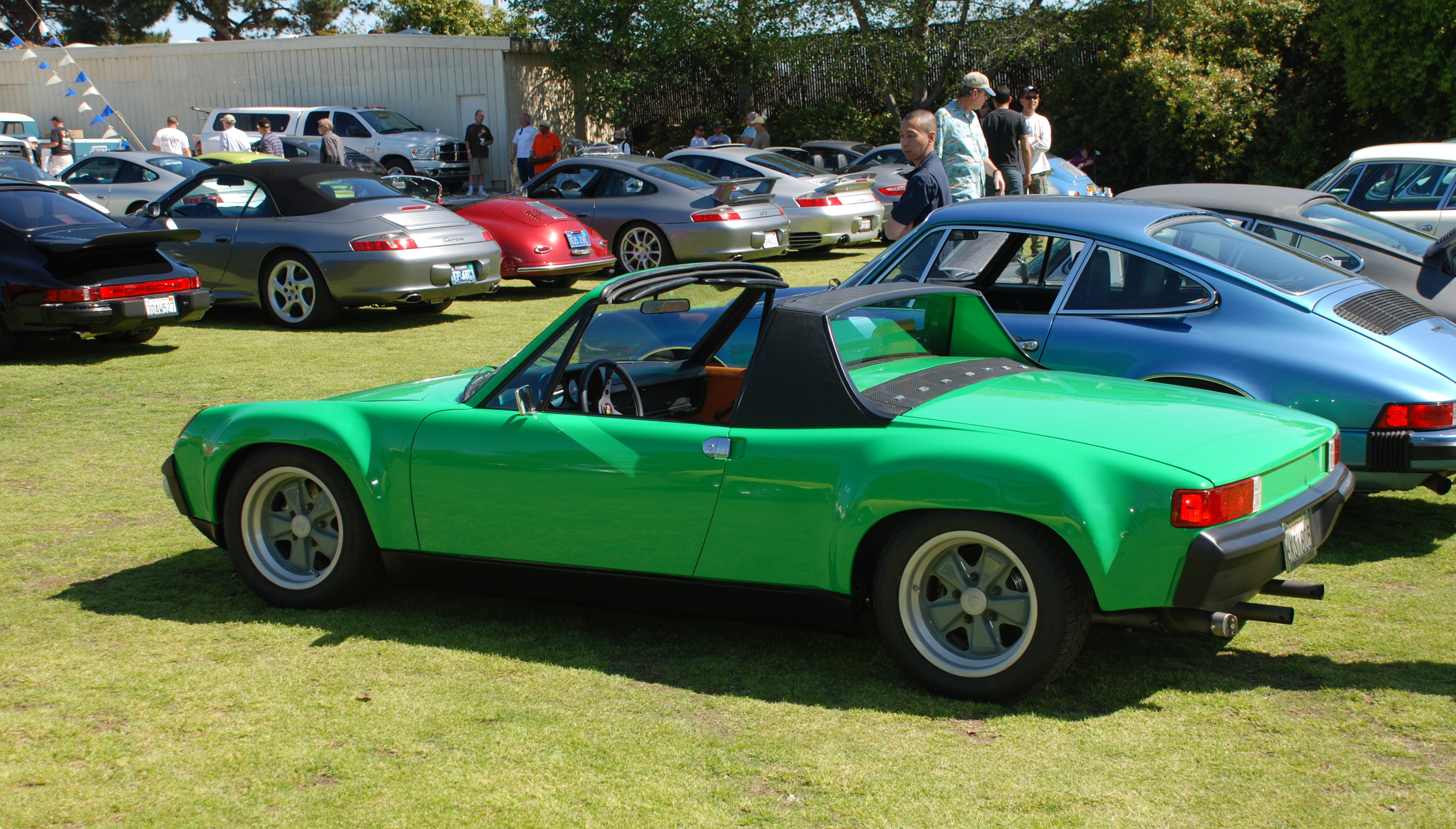

jmill   You've got emerald, viper, Conda and Zambezi g...   Feb 2 2017, 12:53 PM
Chris H.   Those appear to be Conda Green. L2626 is the code...   Feb 2 2017, 03:50 PM
raynekat   Bottom one looks like viper green.   Feb 2 2017, 04:53 PM
jmill   Some pics.   Feb 2 2017, 05:19 PM

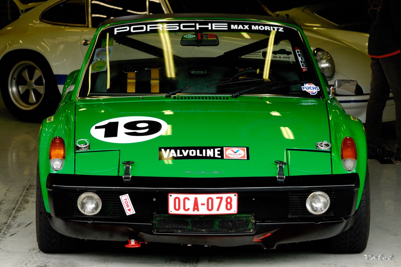

Larmo63   Viper Green is siiiiiiiiiick. The #19 car color w...   Feb 2 2017, 11:16 PM
ConeDodger   The replica flares have more "flange" th...   Feb 2 2017, 11:44 PM
Mitox   The replica flares have more "flange" t...   Feb 3 2017, 06:24 AM
jmill   Not really. I found it on Rennlist. Here's o...   Feb 3 2017, 11:41 AM
Mitox   Not really. I found it on Rennlist. Here's ...   Feb 3 2017, 01:04 PM
jmill   My favorite one.   Feb 3 2017, 02:54 PM
Mitox   My favorite one. I can see why! Very nice...   Feb 3 2017, 03:40 PM

ConeDodger   The Moritz race car is Conda Green. I've seen ...   Apr 16 2017, 07:13 PM
