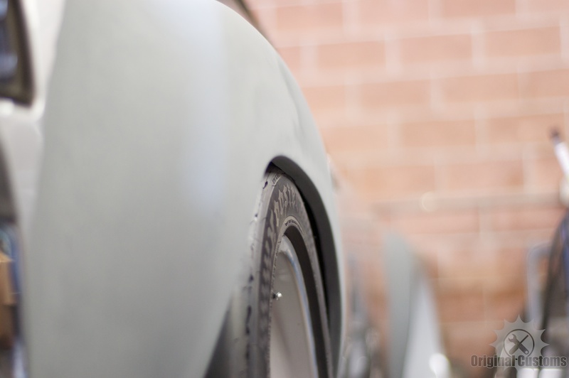

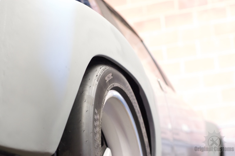

The replica flares have more "flange" than the original factory GT flares. McMark clearances mine a bit to fit the rear tires. In the front, it's not a problem. I'll edit in a picture from my project thread in a minute or two...
Ok, here are before and after pictures of my rear flares. Before would tear up sidewalls. After? Just right!

Thanks, your "before" pic is exactly what my flares look like. At the top, yours now look like roughly 1/4" or maybe slightly more, so that works.
I'm thinking I should trim the lip to about 3/8", and roll the top of the arch up.
