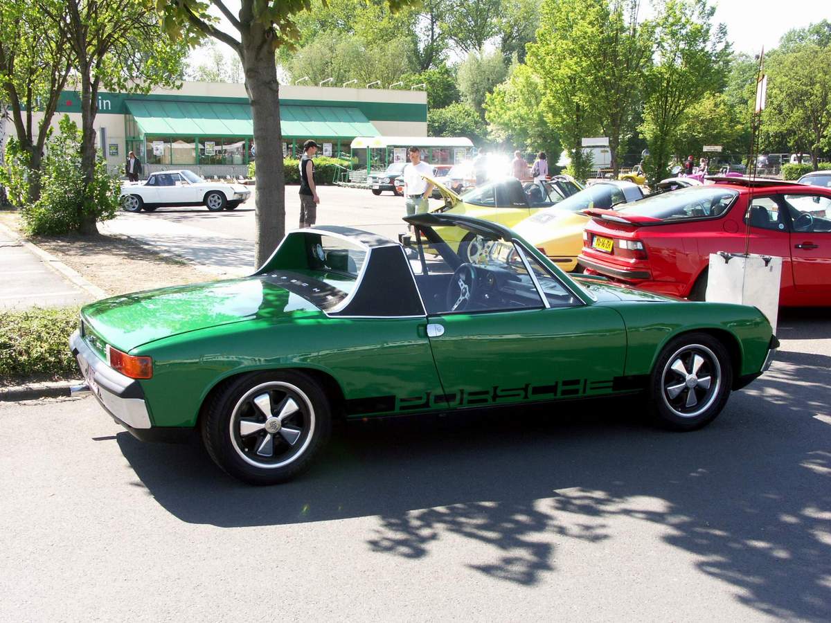

jmill   Not really. I found it on Rennlist. Here's o...   Feb 3 2017, 11:41 AM
Mitox   Not really. I found it on Rennlist. Here's ...   Feb 3 2017, 01:04 PM
jmill   My favorite one.   Feb 3 2017, 02:54 PM
Mitox   My favorite one. I can see why! Very nice...   Feb 3 2017, 03:40 PM
