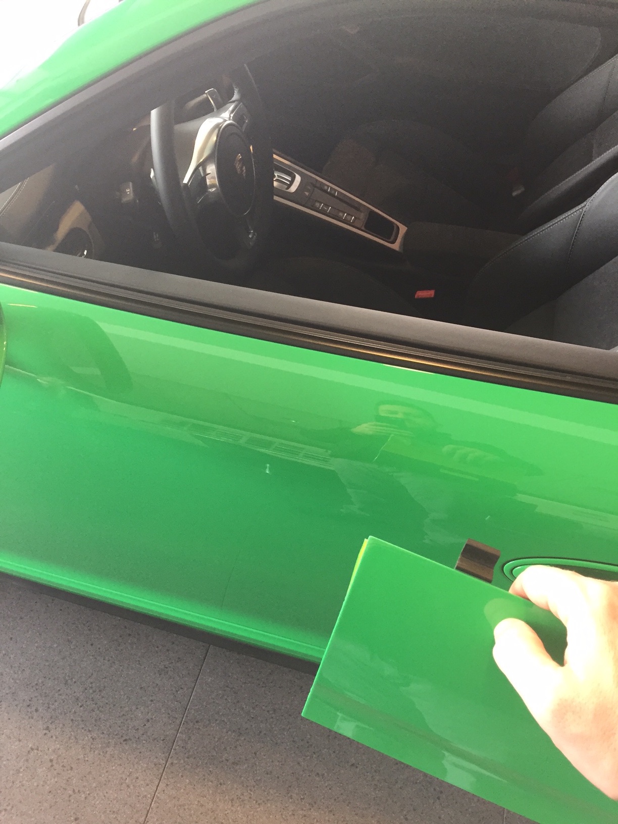

Here's a comparison between green (on the car) and signal green (sample). Too close to call IMHO.

jmill   Here's a comparison between green (on the car)...   Feb 5 2017, 11:17 AM
Mitox   Here's a comparison between green (on the car...   Feb 5 2017, 12:29 PM
